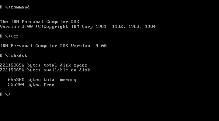

Here's the riddle - how I did the following?
The attachment where_theres_a_will_theres_a_way.png is no longer available

It's a secondary drive. Likely you have a device driver loaded to support it.
This sounds like a limit in int13 support, when parsing the partition table.
I VAGUELY recall reading the revision history / readme for Ontrack Disk Manager, that it originally came as a loadable .sys device driver, and needed to start from a small dos volume.
Maybe something like that here?
If it's just a tweak to the dos kernel, then something similar could be done with a small assembly stub that prods the right bits in ram, along with a proper int13 supplier, like xtide?

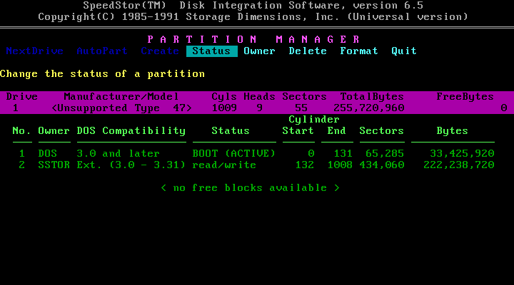

Actually, I used SpeedStor:
The attachment 1.png is no longer available
Note that the 65535 sectors limit is still there.
SpeedStor bypasses this limitation by combining several physical sectors into one "logical sector" - in my scenario it's 4 KB:
The attachment 2.png is no longer available
And yes, it's handled by SSTOR.SYS loaded from CONFIG.SYS.

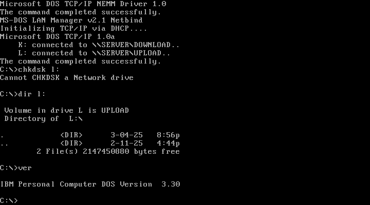

Reply 5 of 49, by Grzyb
Sabina_16bit. wrote on 2025-03-04, 19:25:
Or...there is also an another occassion of a >32MB volume:
I have CD-ROM in 2 of my DOS 3.30 systems,driver VIDECDD.sys is working with both 286(pure 16bit) & DOS 3.30 & the limit does not apply for CDs,I can read full 700MB CD on DOS 3.30.
Indeed, it's also possible to bypass FAT limitations by using a completely different filesystem - eg. ISO9660 supported by MSCDEX.
Microsoft Network Client supports SMB:
The attachment smb.png is no longer available
But of course, such solutions occupy more memory than using the FAT driver, which is already loaded as a part of the DOS kernel.

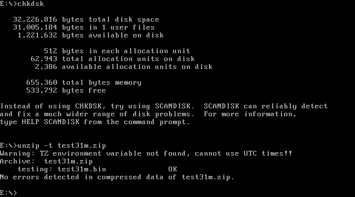

Back to the 60000+ clusters in the original FAT16 filesystem...
DOS 6.22 works fine:
The attachment 622.png is no longer available

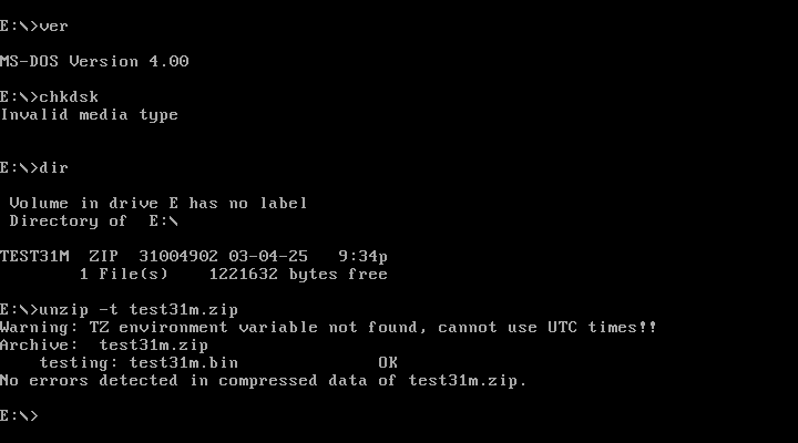

DOS 4.00 - not so fine, but still works:
The attachment 400.png is no longer available

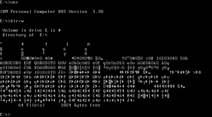

DOS 3.30 - total failure:
The attachment 330.png is no longer available
Looks like the original FAT16 implementation - in DOS 3.x - is indeed limited to 14-bit cluster numbers.
Later DOS versions, however, use full 16-bit cluster numbers - even with <32 MB filesystems, therefore not BIGDOS.

The number of clusters should already fit in 15 bits, right?
But I still get garbage:
The attachment 15m.png is no longer available

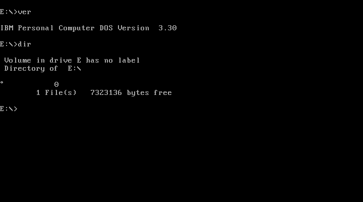

All the garbage in my earlier posts was after I did "mount -o loop -t msdos ...", and written a file there.
Now, fresh after "netdrive create ...":
The attachment empty.png is no longer available
