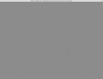

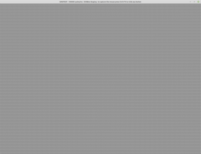

Right now I want to present some tests I've been doing with respect to the scaling and the behavior when switching video modes.
My apologies if any of this is fixed in the latest firmware version - I couldn't find anything about them in the changelogs and I haven't delved into updating the firmware yet... I'll be doing so on Linux and I'm a little worried about doing it wrong and bricking the card.
First, the mode switching: I have some videos if you want to see them, but I'm still experiencing the "blip" when switching DOS video modes, despite the output mode remaining the same.
Example:
- I have the output mode set to 1600x1200x60Hz. Multimode off, Stutterstop off, vsync off (fixed 60Hz). This mode does not change throughout the test, and I can verify it by checking the info on my monitor. I'm using a monitor only, no capture card.
- I'm in DOS text mode
- I change the DOS video mode to any graphics mode
- The monitor blanks for 1-2 seconds as though it has detected a mode change
- But there has not been a mode change. The mode is still 1600x1200x60Hz.
- I change the DOS video mode back to text mode
- There is no "blip" this time. The modeswitch happens instantaneously and my monitor does not see an interruption in the 1600x1200x60Hz signal.
So I'm seeing a blip going from text->graphics, but not from graphics->text.
Note that this happens with any fixed output resolution. I'm just using 1600x1200 as an example. It also happens at 1920x1080 (or any other resolution) on my capture card.
Getting rid of the blip is important to me as it produces the "CRT-like" experience that I'm looking for, especially as a programmer, frequently switching between text and graphics modes and wanting to see the output right away rather than missing those often crucial first 1-2 seconds.
Enabling Multimode makes the blip problem worse, since there is an output mode change corresponding to every DOS mode change. But that's the nature of Multimode, of course.

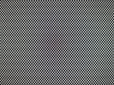

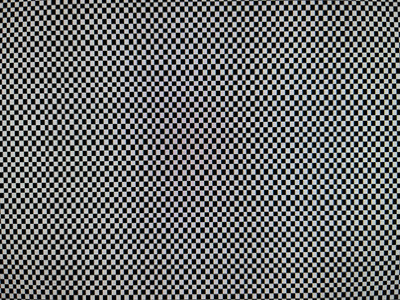

Next, the scaling.
First off, enabling Multimode makes the scaling "perfect". But Multimode has two main problems:
1. My LCD monitor does not let me force the aspect ratio to 4:3. It only lets me set it to "original", which means it preserves the original aspect ratio of the mode rather than stretching it to fill the screen. This means that many of the Multimode modes get scanned at their native non-4:3 aspect ratios. For example text modes come in as 1440x1200 in Multimode, and consequently appear stretched vertically on my screen, despite having perfect scaling.
2. Multimode makes the "blip" when changing video modes unavoidable.

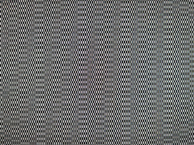

If I fix the resolution to 1600x1200 (or 1080 line modes), the scaling for text modes and 320x200 is still in the "good" realm, which is worlds better than any other scaling solution on the market.
However, the scaling breaks down at 640x200, 640x350, and 640x480 (and, I assume, higher resolutions, but I didn't try those).
The scaling is best in 320x200. Text mode is alright - some wonkiness though. Again, Multimode "fixes" this, but the aspect ratio is no longer 4:3, so it stretches vertically on my monitor (not to mention the modeswitch issue).
Apologies if I'm touching on something you've already tried to accomplish, but can't for some reason due to hardware limitations.
I can't capture 1600x1200 with my capture card, so I'm using my phone to show pixels close up on my monitor. The CRTT output mode is 1600x1200, Multimode off.
I'm using a program I wrote called GRIDTEST - attached at the bottom of this post - that displays a grid of alternating pixels in your choice of the common DOS video modes, perfect for this kind of test.
As my "reference" example of scaling these DOS resolutions to 1600x1200, I'm including screenshots of DOSBox running with a fixed output resolution of 1600x1200 in windowed mode, set to use OpenGL rendering.
The DOSBox screenshots show what "should" be possible when scaling to a fixed resolution instead of a dynamically changing one, assuming there isn't some limitation with CRTT I don't know about.
320x200 comparison between CRTT and DOSBox (looks almost identical - here the CRTT is actually doing a little better than DOSBox as it fudges the pixels slightly to make them more uniform without sacrificing almost any sharpness):
The attachment crtt_320x200_1600x1200.jpg is no longer available
The attachment dosbox_320x200_1600x1200.png is no longer available
640x200 comparison between CRTT and DOSBox (here the difference becomes stark, DOSBox is the one fudging the pixels for uniformity now, making them as sharp as possible without making them uneven):
The attachment crtt_640x200_1600x1200.jpg is no longer available
The attachment dosbox_640x200_1600x1200.png is no longer available

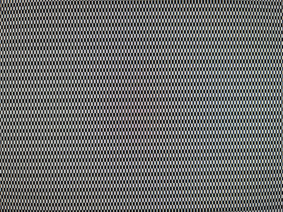

Reply 208 of 244, by keenmaster486

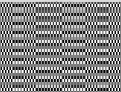

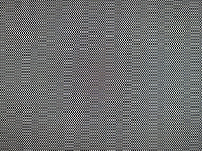

640x350 comparison between CRTT and DOSBox:
The attachment crtt_640x350_1600x1200.jpg is no longer available
The attachment dosbox_640x350_1600x1200.png is no longer available
640x480 comparison between CRTT and DOSBox:
The attachment crtt_640x480_1600x1200.jpg is no longer available
The attachment dosbox_640x480_1600x1200.png is no longer available

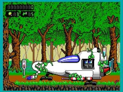

These screenshots were captured with my EVGA XR-1 Lite, scanning 1440x1080 output from the CRTT as 1920x1080, upscaled to 1920x1440 by OBS.
I chose 1440x1080 so that I can get the correct aspect ratio on both my monitor and the capture card at the same time.
These are better results than I have gotten from any other VGA capture methods. Previously the best I could do was the OSSC, and its output was rather fuzzy no matter what I did.
The scaling, however, I think could still use some fudging of pixels to make them look more uniform. It suffers somewhat from unevenness. It's not as noticeable except in games like this one that frequently use grid patterns for dithering.
The first screenshot is with "point scaling" turned on in OBS. The second is with the default scaling.

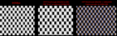

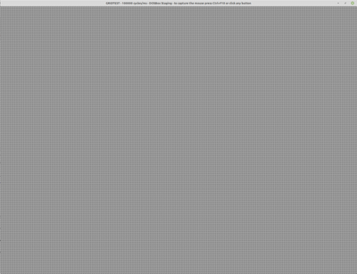

keenmaster486 wrote on 2025-02-27, 18:01:
GRIDTEST program:
The attachment GRIDTEST.EXE is no longer available

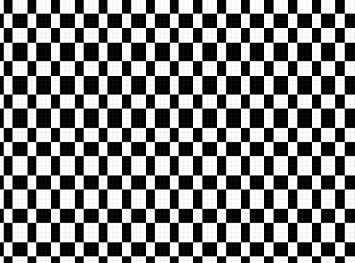

Thanks for this test program. I gave this a run at 640x350 outputting to fixed 1600x1200, and capturing in OBS. The output pattern here looks correct and as expected:
The attachment fixed_resolution_upscaled_pixel_grid.png is no longer available
Horizontally, 1600 / 640 = 2.5, so 50% of source pixels should upscale to 2 pixels, and 50% of them should upscale to 3 pixels. So the upscaling will alternate each pixel between 2,3,2,3,2,3,2... upscaling pattern.

Thanks for this test program. I gave this a run at 640x350 outputting to fixed 1600x1200, and capturing in OBS. The output patte […]
Filenamefixed_resolution_upscaled_pixel_grid.png File size77.03 KiBViews36 viewsFile license
Vertically, 1200 / 350 = 3.428571428571429, so 42.8% of source pixels should upscale to 4 pixels, and 57.1% of source pixels should upscale to 3 pixels. So the upscaling will alternate between 3 and 4 pixels in almost 50-50 manner.
I agree that the result is not great for dithered patterns, although there is no good strategy to my knowledge to improve dithers, that would not cause more distortion to the image.
Correct, this is exactly the pattern I'm seeing - and I agree it's the best solution if you want to keep perfect sharpness on the pixels.
However, I think it could benefit from just a *little* bit of "fudging" to make the pixels look more even (for these higher resolutions and for text mode, not for 320x200 upscaled to 1600x1200! But 320x200 upscaled to, say, 1440x1080 with overscan border could also benefit from this, I've noticed).
Here's a detail view of how DOSBox, for example, handles 640x350 upscaled to 1600x1200:
The attachment dosbox_640x350_1600x1200_detail.png is no longer available
I'm not really sure what this type of scaling is called. But it seems to involve shading a little around the edges of the pixels so that they appear perfectly even to the eye when viewed at 1x.
To my eye this is a good compromise between the ultra-fuzzy, brain dead scaling that the typical LCD monitor or VGA to HDMI converter does, and perfectly sharp pixels at the cost of evenness.
I understand the implementation of this algorithm, if you even wanted to attempt it, might cost some FPGA time. For example maybe this means enabling it moves 1600x1200 into the realm of "might work" and 1440x1080 becomes the new "probably stable" resolution. To me personally that would be an acceptable tradeoff, especially if it were an optional thing.
You can see how nice it looks if you set DOSBox to opengl output (not openglnb), a fixed windowed resolution of 1600x1200 (or even 1440x1080), and run GRIDTEST with 640x200, 640x350, or 640x480.
Setting the DOSBox output to openglnb results in the same behavior as CRTT. This is the scaling mode I used to use, but then I saw the light of having a little bit of fudging for even pixels.
I might even say that this is especially important for text mode, where perfectly sharp scaling usually results in jagged, uneven letters that don't look great.
This way it also looks very much like the actual output from a CRT monitor, which is almost never perfectly sharp at these higher resolutions, especially in the early 90s. But 320x200 will be much closer to "perfectly sharp".
Another way of looking at it is that a CRT will *never* have uneven pixels. It will have varying degrees of sharpness depending on the quality of the tube and circuitry, but the individual pixels will never be uneven.
clb wrote on 2025-03-04, 13:08:
In your camera photos, I can see an effect that looks like double scaling has taken place.
Yes, I am using a 2560x1440 monitor, so it upscales a little. I should have set it to "just scan" mode, which doesn't scale at all, so the camera photos would look more accurate. But the effect is the same either way. The monitor's scaling from 1200->1440 affects the way it looks only slightly.

This looks like the "Area upsampling" mode, which CRT Terminator achieves with the Multimode operation, and OBS does with the "Area" scaling mode.
I took captures of GRIDTEST in the different modes:
The attachment upscaling_modes.png is no longer available
The mobile phone camera capture is a bit hard to compare against the others, though visually it does look effectively the same as the DOSBox and the OBS captures.
I understand you are asking to get the visual quality of MultiMode filtering mode, without the use of MultiMode. If it were possible, I would love to be able to implement this scaling directly in the FPGA without the use of the MultiMode strategy, though unfortunately it was a necessary compromise to rely on the LCD display's upscaling circuitry to implement this scaling - there was not enough performance available otherwise. 🙁
