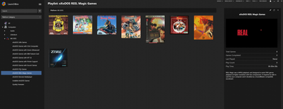

Most of it is working just fine in staging. I have 8 titles currently setup and running in REMOVED.
The games I don't have yet are due to the fact that those who own the discs haven't imaged them =)
Currently setup and working fine are:
Return to Zork
The Lord of the Rings
The Horde
Flash Traffic
Entity
Drug Wars
Dragon's Lair
Crime Patrol
I do have Space Ace as well, but that one is still not running properly yet.
