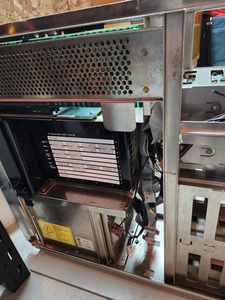

I'll see what I can do. Here are more info on why I'm trying to achieve that.
I own an IBM 5363 (mini mainframe). The hard disk in there was formatted using 256 bytes sector because that's what the OS needs (called SSP). However it seems that these drives were pre-formatted by IBM internally as there is no option in all software I found to do the fomat. When I try to re-install the OS it gives me an error that the "alternate sector table" is not found, related to spare sectors.
Of course I don't know how to format those sectors as I don't know how the controller in there does it. However I should receive a binary dump from another working system soon. I'll try to analyze the bytes and hope to find the way it does it.
The mistake I did was to format the drive in my PC using the WD card. I just wanted to learn and play with ESDI stuff. I never realized that I couldn't re-format it in the IBM later on.

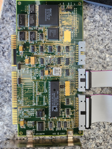

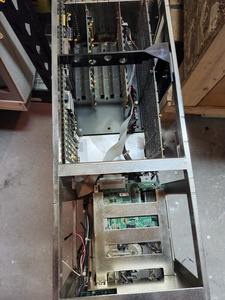

I should work with the WD1007 and try to "talk" to the drive. This document is very interesting (see attached, page 14 in particular). I might play with it and the debug from dos or writing a simple C program for dos. I also disassembled the WDFMT.exe file.
I understand that the binary dump has to be low level, otherwise I'll get only the payload data.
At least I know the drive is capable of 256 or 512 bytes sector. I think raw sector is 620ish bytes. It's a 320meg hard disk, in the PC I can format full 320meg but in the IBM it sees around 115meg. probably by querying the drive and assuming 256 bytes and doing the math.
I'm adding pictures, documents and my personal notes about the IBM 0671-E15 if that can help. I know my notes are not 100% accurate. That's what I have found so far.
Sure IBM were probably charging a lot of money for all this!

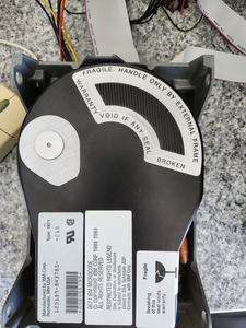

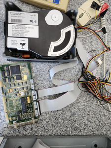

Reply 9 of 11, by Pitou
some more...
    1.65 MiB
    220 views
    1.49 MiB
    220 views
    Drive
Reply 10 of 11, by Deunan
That's a nice, big HDD. I like those. Sadly yes, everything mechanical will die at some point and these drives are no exception.
I don't understand why there are switches that change the head count, possibly to accomodate machines that could not work with more heads for some reason? Or to better emulate some older drive model? BTW you probably already know that on ESDI the drive select count starts with 1 - because 0 is reserved for no selection.
Most importantly there is a switch that causes the drive to report 68 sectors - I think that it means the HDD does not support set bytes per sector command but it does allow one of these 2 configurations. That might be a good thing, less stuff to worry about. Just flip the switch and it will be IBM compatible again (if you can write LLF to it). That being said keep trying to talk to the drive via WD1007 or some custom HW. The more you know about it the better.
