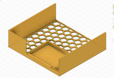

Reply 41 of 72, by mbalmer
Just as a starting point: A 5.25" drive bay mount for the ZuluIDE.
This is in NO WAY finished, but it's a starting point that I can work from to figure out placement for the hardware interface.
In other words: I'm actively working on it.

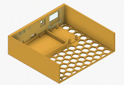

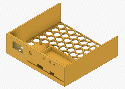

Reply 43 of 72, by mbalmer
Update 2:
More modifications; I've now added a place for the screen, rotary encoder, buttons, and an optional LED you can run to the LED header on the ZuluIDE. The board currently mounts completely flush to the front of the bezel; I will likely change that once I've determined that everything else mounts like it should.
I'm going to try a test print of it tonight and see how it works.

Reply 58 of 72, by mbalmer
dzeq_pl wrote on 2025-03-13, 18:58:
Is there a stl file for it somewhere. I wanteted to print one for mysfelf? I've made same test "Frankenstein like" interface us […]
I've made same test "Frankenstein like" interface using old ctrl_board_v1p6,I've allready had 4 empty boards from ZuluSCSI project. Wanted to try if I can fit it into your design.
How You plan to mount switches to that case, some additional "board" to screw it?, glue it?
Regards
Jacek
Not just yet; I've been working on and off on it over the past couple of weeks in between other projects I've got running.
Mounting switches is glued-in right now and will remain that way for the moment - until I sit down and do a redesign of the control board interface to lay it out such that the control board can be mounted to the front bezel and still fit everything else in the height/width of a drive slot.
The encoder is screwed in with a retaining nut on the front like a Gotek's encoder. The display has four small standoffs on the back side of the bezel that take thread-cutting plastic screws to secure it to the bezel.
It would potentially be possible to use push switches that, like the encoder, use a retaining nut to secure them, but those are quite costly, so I'm just sticking with tactile switches for now. The 6mm ones with 6mm actuators seem to be about the right length.
Everything I'm doing currently is in Fusion, so all of my test prints have just been straight to G-code for now.
Reply 59 of 72, by Lomdar67
mbalmer wrote on 2025-03-13, 19:32:
Wouldn't it be much more easier to simply create a new control board interface with an Micro SD-Card extension on it, optimized for the front panel. So the ZuluIDE itself goes in the back of the 5.25 bay and is connected with the front panel with the SD-Card extension and the Qwiic Port?
The recent design of the ZuluIDE isn't optimized for what you a trying to do. A Micro SD-Card extension could quite easily solve this problem and they aren't very expensive.
