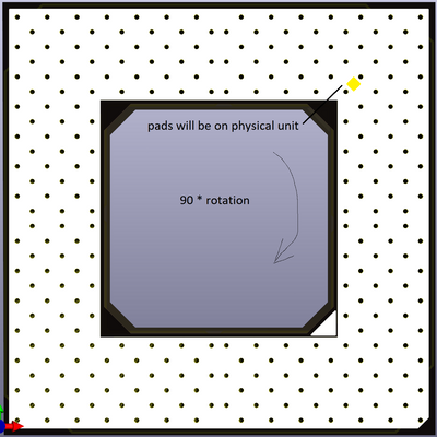

The shim:
a) make one shim as you've made it, but you'd want to reduce the size of the diamond pads to match the new rotator board
b) make one shim with regulator metalic through holes in place of the pads. No pads.
Sphere478 wrote on 2023-01-03, 22:52:
It might be possible to do a offset thru hole. I don’t find it as elegant in this case though. And it would definitely be a full redesign.
I think it is best to create a part so more people can assemble it and with a greater degree of success. Elegance would only come afterwards in opinion. I still have my doubts as to my ability to assemble this.
It would be even more cramped on the inner layers with the larger vias(now being larger plated thru holes for pins) also physically larger obviously.
The least space consuming would be to have the solder pads as the vias on the existing design.

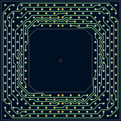

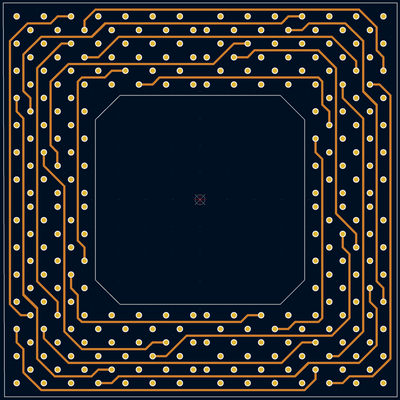

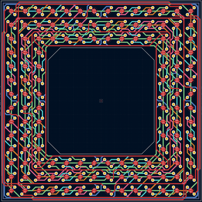

Reply 101 of 121, by Sphere478
CW 90 degree rotator prototype1 6 layer no ground.zip
1.28 MiB
47 downloads
files
    160.62 KiB
    1058 views
    199.25 KiB
    1090 views
    167.25 KiB
    1090 views
    529.54 KiB
    1090 views

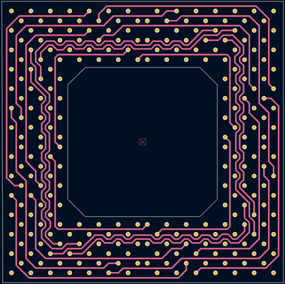

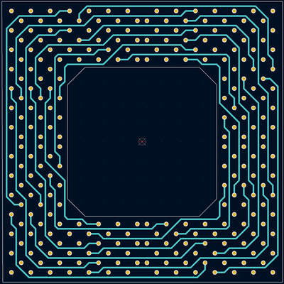

Reply 102 of 121, by Sphere478
layers
    63.74 KiB
    1090 views
    68.41 KiB
    1090 views
    67.2 KiB
    1090 views
    76.73 KiB
    1090 views
Sphere's PCB projects.

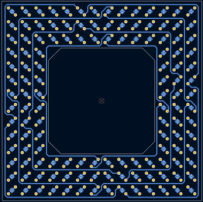

Reply 103 of 121, by Sphere478
shims

Reply 106 of 121, by Sphere478
The shims should be correct
I made one with metal plated holes and one with metal plated holes and diamond pads
Give it a shot.
I think maybe do the two rotators. Then immobilize them somehow, and then do the ends.
Maybe it makes sense to just tin them a little and heat them down to the rotator then solder the pins on by hand one by one then push the plastic on.
Idk. It’s gonna be difficult to assemble though for sure. Sorry 🙁
Jlc may actually be able to assemble these… ask them?
You may be able to make your own solder wire cutter to make your own metered size solder balls

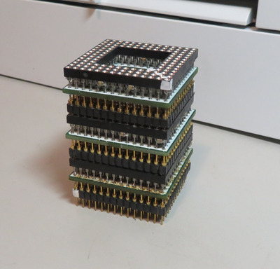

Batyra, do you know someone who is familiar with, or interested in, doing PCB layout? Your PM led me to believe that you may know someone. If yes, they can probably get a start with sphere's gerbers. There should be sufficient detail in this thread about my original proposal.
I think we should strive for through-hole top, and through-hole bottom, similar to how the SXL2 interposer was laid out. Or possibly through hole bottom, surface mount top socket. There should be a different PCB for each orientation, that is, a PCB for 90, 180, and 270 degrees. We want to reduce noise, trance length, inductance, parasitics, etc as much as possible, so we'd want Vcc and GND planes. We'd probably need 8 layers. Up to 8 layers is still cheap on JLCPCB. It is OK to exceed the 36x36 mm footprint of the PGA132 if needed.

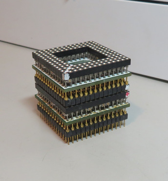

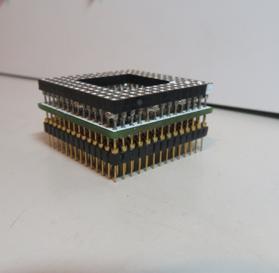

We left off in this thread with a plan Sphere was pushing: a BGA design that uses only a 90-degree board. 180 deg would be two stacked 90 deg boards. 270 deg would be three stacked 90 deg boards. The BGA design is unrealistic for hobbyists, it increases trace lengths for 180 deg and 270 deg orientations, and is missing GND/VCC planes. For the Panda 386V, you'd want a 180 deg or maybe 270 deg rotator, but the existing design, assembled by a hobbyist w/out BGA will contain too many parasitics for your application. You can probably only get away with 90 deg rotator though.
Below is what I assembled some time ago. Adding the filtering caps helped getting the board to at least turn on.
90 degree rotator:
524.63 KiB
94 views
90 degree rotator with added caps:
515.09 KiB
94 views
If you wanted to sandwich two of these together, 180 degree would look like this:
389.2 KiB
94 views
And of course, 270 degrees:
591.03 KiB
94 views
I have run tests with the SXL2 at 85 MHz using these rotators. Only 90-degree worked, but I feel it is on the edge because other assemblies of mine would not work at 85 MHz, but would work at lower frequencies. In the rotator photos, you see one with red markings on it - this unit didn't work at all. So I manually soldered all the pins; you can see the solder looks like a mess on it. Still didn't work. Then I swapped motherboards, and it worked. Red flag. The existing rotators are too noisy.
