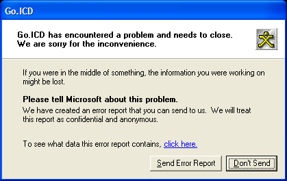

Expendable crashes while loading the first level. The crash occurs just as the level music begins to play and the 3D environment would typically appear. The screen turns black and Windows reports "Go.ICD has encountered a problem and needs to close."

1) Started go.exe with command line switch -nocputest. Immediate crash to desktop; same error message.
2) Created a compatibility shim with Microsoft Application Compatibility Toolkit. Targeted go.exe and used the EmulateSlowCPU option. go.exe fails to launch; no error message.
3) Created another compatibility shim with Microsoft Application Compatibility Toolkit. Targeted go.exe and used the SingleProcAffinity option. No change.
4) Applied Tuxality's Matrox G400 EMBM patch. No change.
Information
I ran into the same problem a few years ago with a Precision 380, Pentium 4 670, and GeForce 7900 GTX (this system). I don't recall ever finding a solution. It also looks like this thread describes the same issue. Some members reported success with the -nocputest command line switch, but this did not work for others, including the OP.
My current test setup has a slow single core CPU, so that is somewhat unlikely to be the issue. However, it also has an Intel IGP. That is highly likely to be contributing to the issue. The standard benchmarks all run without a hitch (3DMark2000, XL-R8R, 3DMark2001 SE, even AquaMark3 and Codecreatures), but support for DirectX 6 games was probably pretty low on the driver writers' priority list.
Has anyone run into a similar problem and found a solution, other than the -nocputest switch which is not working in this case?

Fixed this by using the GoG version of Expendable instead of the retail CD. My hunch is the game's SafeDisc DRM didn't like having a USB optical drive in the mix.
The GoG version was slow to install but runs great otherwise.

Please add the exe to the data execution prevention whitelist in the Windows control panel system properties applet.
