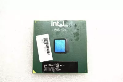

So this is my second attempt at posting this as I had messed up my previous post about my Win 95 motherboard. I already have a Win XP and a Win 98 system which I had great fun in assembling. Now I want a DOS/ Win 95 system and I am not too uppity about the period correctness or performance. However I do want some compatibility with the Win 95 era games and a few DOS games.

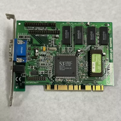

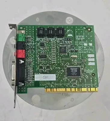

I have gotten a Diamond Stealth 3D 2000 S3 Virge card and an Ensoniq Audio PCI(E583421 Chipset) sound card. My CPU is a Intel Pentium III Processor(133 MHz FSB SL3XY).
The attachment cpu.webp is no longer available

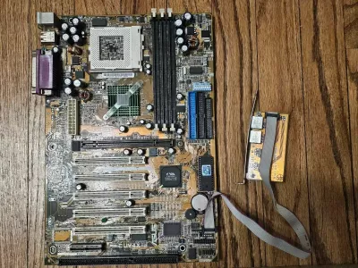

I have also chosen the Asus CUV4X Socket 370 Motherboard motherboard for the build. In the initial post I had put up the wrong motherboard. I had heard there were problems with the VIA chipsets but as I am a noob in the Win 95 era hardware I am unsure if that would be too concerning for me.

I was wondering if the parts would be a good fit for my use case. I do not have partpickers to know about the compatibility. I want to make it a strictly Win 95/dos era build.

Reply 1 of 37, by dionb
Not sure what "problems" with Via chipsets you are referring to. 90% of problems people have it that because Win98SE has drivers built in for Intel chipsets, they don't realize installing motherboard chipset drivers is a thing. Most of the other 10% is a specific interop issue with the Sound Blaster Live series of cards and the Via 686B southbridge. You don't have an SBLive, so not relevant. Windows 95 helpfully lacks built-in motherboard chipset drivers for Intel chipsets too, so you'll need to install drivers for Win95 regardless.
Aside from that, if you want DOS, an ISA sound card and so a motherboard with ISA slots makes life a lot easier. This ES137x card has DOS support, but like most PCI cards under DOS, needs a TSR program to work that eats a bit of memory and limits compatibility. The parts you list look great for a Windows 95 system that will run very quickly (motherboard and CPU are from Win98SE era), but I'd suggest something else for DOS, purely for the ISA slot.
Reply 2 of 37, by megatron-uk
That motherboard has an ISA slot, I would recommend using it for an ISA sound card; you will get much better compatibility with DOS if you do.
Something like an ESS 1868 based card should be easy to find and fairly cheap, with good Soundblaster Pro compatibility and no need to load drivers.

If you have slot 1 board it would be perfect fit for win95 , any pentium II cpu do the job .

by default, the p3 is not a good fit for win95 due to lack of proper SSE support under that OS.
Reply 5 of 37, by STX
In Windows 95, a Pentium III will work like an overclocked Pentium II, which is fine. I have a late-90s Compaq Deskpro that had Windows 95C (also known as Windows 95 OSR2.5) factory-installed, and its 550 MHz Slot 1 Pentium III works fine as a fast Pentium II. Windows 95-era software doesn't even try to use SSE because SSE processors weren't available until 1999, so the lack of SSE support in Windows 95C is not a problem for what you want to do. Just make sure that the version of Windows 95 that you install is an OSR 2.x version (either 95B or 95C); see the Windows 95 page on Wikipedia for details if you're interested.

Thanks for all the feedback. Good to know that the build will work. Honestly, I know little about what hardware was in vogue during the Win 95 era(I grew up in the glory days of XP).
I chose the 370 socket as I got a fairly good deal on ebay(compared to other motherboards of the era). The other parts were also affordable. If I go for another build I will look into socket 1 and other sockets of the era. Generally I prefer to go for easily accessible, inexpensive parts I can bargain for on ebay.

I am glad that the Via chipset won`t be a problem. I read somewhere on the forum that Via chipsets were to be avoided due to the issues and someone even suggested some patches like memory interleave enabler. I never used any motherboards of the era so I assumed it might become an issue later on.
As for the ISA sound card I did read about it here but I could not find any decently priced ones while I was searching for a sound card on ebay. The ones I tend to prefer range from 10 - 20 $ or sometimes even less than that. This is the first time I am ever having an ISA slot motherboard so I was also unsure about the compatibility.
For DOS I will probably go for another build later. From the looks of it there is a steep rise in prices of DOS era hardware(atleast for motherboards) compared to XP/Win 9x systems.
