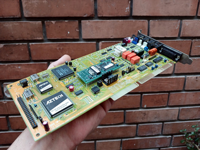

Recapped this Aztech Washington 16 sound card, also replaced the caps on the CL-GD5434 graphics card with smaller caps.

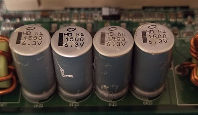

Recapped my recently acquired QDI Advance 10T. Green 1000nF ones were all wasted.
However bigger 1500nF are all looking good. Never seen this brand before.
Reply 29482 of 30583, by PcBytes
1500uF is Nichicon HD. I would replace those as well, I've seen Nichicon HDs in that casing go bad.
Reply 29483 of 30583, by vutt
Yeah I probably should check those Nichicon's out as well.

My guess is some of the caps may have been a little dry and it took a few power cycles to revive them. Have seen that before in a few of my older boards, I usually power them up and leave them be for 15 - 20 mins to get warm and let the old caps charge back up. Either they will come back at full health or they will fail and need replacing.
Should say this really only helps old electrolytic caps that haven't been powered up in a good while and still look to be in good physical condition, if they have bulged or leaked then this wont help them at all.

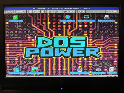

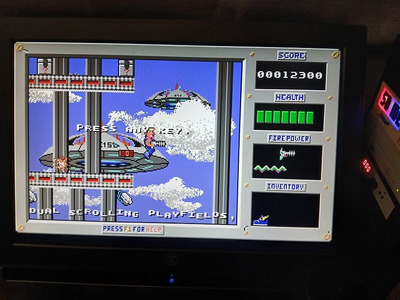

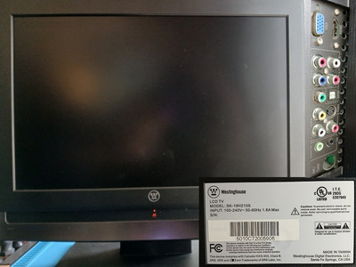

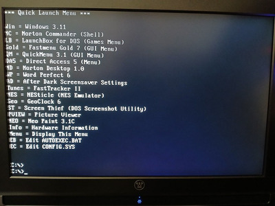

I've been looking for a "good" old school LCD TV I could use for testing a variety of old hardware, from computers to game consoles, and whatever else I happen to need.
A while back, I was given a Westinghouse SK-19H210S and was told it was "working great when it was put away". Well, I finally got around to testing it out today.
So far, so good. I was most curious how it would handle DOS, and while DOS text is not as sharp and clear as on my Dell LCD monitor, it works good. I may be able to clear up the DOS text a bit in settings. Either way I think this TV will fit what I need nicely. It's got all the inputs I wanted and seems to handle DOS. For a free TV, I'm happy.

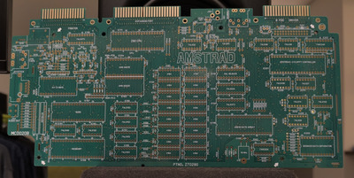

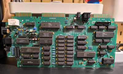

I had an Amstrad CPC 6128 for which, after extensive troubleshooting, the conclusion was that it must have some non-visible damage somewhere on the board itself. At that time there was a replica PCB for the 464 available (covered by multiple YouTubers including Noel's Retro Lab -a popular place for CPC repairs) but not for the 6128, so it was stored for parts. Only recently I found out by accident while browsing the guy's store for something else that now there is, it seems it never got the same publicity.
With all the ICs on my board confirmed working, I just had to get it and this beauty arrived
The attachment 1743755591368.jpg is no longer available
I decided to install new passive components and everything else I could easily source, sockets for all ICs, and to improve areas were Amstrad cheaped out (like adding a connector for the floppy cable which is originally soldered to the board), ending up with this
The attachment 1743755445858.jpg is no longer available
It was a fan project, it took a lot of time but since there is no hurry with these things it's not necessarily bad. It meant multiple enjoyable evenings tinkering, listening to music, adding some beer to the mix... It was the first computer I used, so hopefully this one will outlive me without having to worry again about a working 6128.

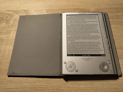

I got a vintage eBook reader from Sony - a PRS-505. It's so ancient, it doesn't even have touch controls yet - instead, you get a big block of aluminum with lots of keys that are very satisfying to press.
I replaced the internal battery, struggled for an hour when putting it back together and loaded it up with a custom software (PRS Plus), my favorite font (Uni Neue) and a myriad of books.
This thing is amazing. I just have to figure out how to make my own leather case now (or adapt one for a different reader), since the original one is unobtanium and mine is falling apart.

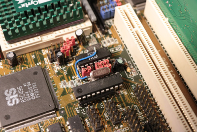

Today I finally got a new clock generator for this mainboard:

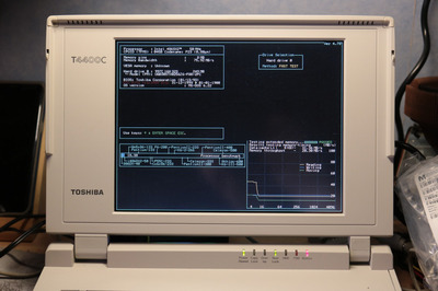

The last few days I've been going at my Toshiba T4400C collection trying to get them all working - I have at last got to enjoy o […]
The last few days I've been going at my Toshiba T4400C collection trying to get them all working - I have at last got to enjoy one and it's a real speed demon...
The attachment IMG_5299 (Custom).JPG is no longer available
Well, it's an ISA system from like 1991 / 1992, it's fast for its time. This one is running an SX2-50 processor instead of the regular SX-25.

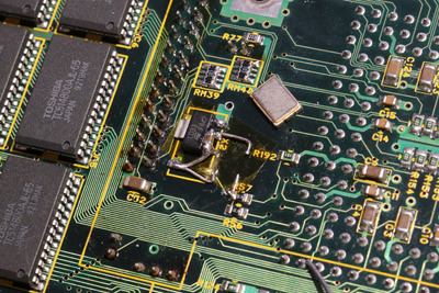

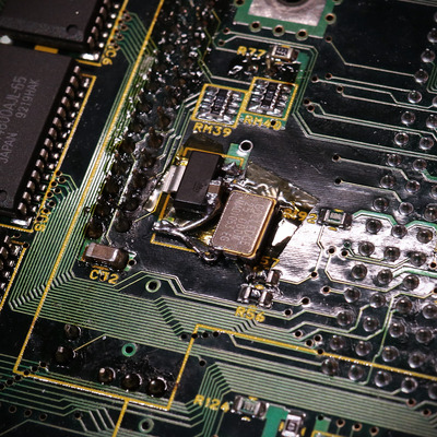

Two out of four had dead motherboards and I tracked it down on both of them, to the clock generator which is a little SPXO like a surface mount version of a clock can like the one wiretap made a replacement for.
One mainboard I was able to use the working 25mhz clock generator from another motherboard that was broken in other ways, which is now just for parts. That's three out of four working but getting a new 5 volt 25mhz (or 33mhz) clock generator that will fit in the limited space is not easy, it's not micro soldering but a can clock would be too big.
There are some 5v 25mhz clock generators I found but that means waiting for parts to come in and I wanted them all fixed today. And they need significant adapting to fit the weird footprint this clock generator used.
Going through my box of scrap boards I found a 25mhz crystal on an office pbx system board, but it seems to be 3.3v - which requires stepping down because the Toshiba T4400 is 5v all the way, 3.3v was not invented yet when this thing was made. Using a 3.3v LDO, a 1uF MLCC capacitor and some cut capacitor leads as traces, it's all bodged into place:
The attachment t4400c-new-clock-wiring.JPG is no longer available
The attachment t4400c-new-clock.JPG is no longer available
And that works, hooray. Then I found out its keyboard is broken with the enter key not working, which makes it pretty useless. The keyboards on these, the T4500 / T4600 / T4700 / T4800 / T4900 / T1900 laptops are made by Alps and I can't see a way to fix this keyboard, there's a little 3-leg chip glued to the flex pcb and that connects to the enter-key-pad - I can't fix that like I can a regular membrane keyboard.

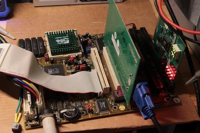

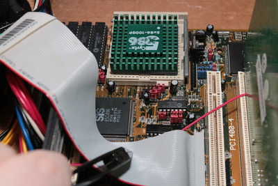

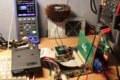

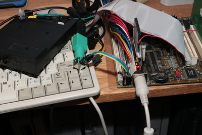

I have been trying to use the motherboard I fixed here, my Taken PCI400-4 which was working after a socket replacement and some loose pins around the southbridge resoldered: Re: Bought these (retro) hardware today
I was trying to test an ISA soundcard on it but it wouldn't boot reliably, getting stuck on / flipping between "C0" and "C1" post codes. Initially I thought it was another loose pin on one of the chipsets so spent ages reflowing the solder on those but to no avail.
Shoulda checked the basics at this point specifically clockspeed, but after some time figured out that the board would boot normally if heated around the CPU / northbridge area which is why I thought it was the northbridge. It would work sometimes when started up but it seemed whenever I left it for a while and it got cold, it would go back to being broken.
Using the hot air with a nozzle I was able to narrow it down to the area around the clock generator, the ARK 915A which has a bash mark on it:
The attachment IMG_5162 (Custom) (1).JPG is no longer available
Checking with the oscilloscope it was showing an unstable ~9mhz on the main cpu clock instead of the 33mhz it's supposed to be. Can't find a datasheet for the ARK 915A or Macronix MX8318 clock generators, but the MX8315 is pretty close. There was no clock on the 14.318mhz crystal so I thought perhaps it was the crystal that was bad, swapped that and no difference 😐
The conclusion seems to be that there's a broken bond wire inside the ARK 915A clock generator since borrowing the MX8318 from my Zida 4DPS has made the board reliable again.
When the ARK 915A clock generator is heated up then it will work with the crystal and do its job properly, but when cold the crystal oscillator is dead so I assume that the XO crystal output pin of the clock generator which drives the oscillator, only has a working connection when warm.
If I heat the ARK 915A then it works and it seems to keep working if it works when it starts up, so a heater atop the chip could work. Mechanical pressure also seems to work so I might try some kind of clip on top of the chip to keep pressure on it.
Or I could look at making some alternative clock generator work, I'd rather not do that and replacements for the ARK 915A or MX8318 both seem to be unavailable. Getting an alternative clock generator working would be a lot of work...
Anyways, now the board works again (albeit at the cost of the 4DPS which I'm not using right now) and it's set up for a Cyrix 5x86 processor I thought I'd try out my 5x86 chips - the IBM one works perfectly and seems to run very cool.

The floppy controller on this Taken PCI400 board was not working, giving a floppy disk fail message in the BIOS and not even trying to move the heads. The board around the floppy controller area is immaculate, but these faults don't exist in a vacuum so I started comparing my Taken PCI400 against the Zida 4DPS - the floppy controller (super i/o) chip on the 4DPS has a 24mhz crystal by it, but there's no crystal on the Taken PCI400...
Spent a *while* trying to find where the floppy controller's clock input linked to but it seems to go to pin #5 of the clock generator chip, which I'd swapped out with the clock generator from the Zida 4DPS (this kills the 4DPS).
Checking pin #5 of the clkgen with the oscilloscope when it's on shows that with the MX8318 gives out 16.24mhz - there's yer prahblem. That should be 24mhz according to the W83787IF datasheet and the clock crystal on the Zida 4DPS by the super i/o chip.
So it seems that the Ark 915A incorporates a couple more clocks which the PCI400 makes full use of, not possible to swap the ARK 915A for the MX8318 and still have the board 100% working.
Put the ARK 915A clock generator back and it still does that thing where when it's cold it'll give out an unstable ~10mhz to the cpu which causes it to fail to boot up. It gets better and worse as it gets warmer/colder and it seems that pressing on the chip makes it work more reliably. Here I've tried a metal springy clip on top of the chip to apply pressure, it didn't really work...
The attachment IMG_5328 (Custom).JPG is no longer available
Trying another way instead I moved pins 2 (crystal output) and 3 (crystal input or frequency) input out of the socket so that the ARK 915A has no connection to the 14.318mhz crystal that the PLL bases all other frequencies off of. Hooked up the frequency generator to pin 3 and ground and fed it 14.318mhz and it now works every time. This bypasses the damaged connection that I think is on the crystal-output pin that would normally drive the crystal.
Gonna see if I can use some useless microcontroller to use / drive this crystal instead and save this board so it can work all the time instead of only sometimes / only when warmed up.
The attachment IMG_5329 (Custom).JPG is no longer available
Lately it seems all the problems I'm facing are clock frequency issues, I could put an SPXO frequency generator there instead but 5v input simple oscillators are hard to find. I actually broke apart one of the broken SMD SPXO oscillators from one of the Toshiba T4400C mainboards and it's got a little tube type crystal inside along with some silicon that drives it, guess the bond wires melt when it gets overvoltage.
edit: aww heck yeah. Went through my box of spare microcontrollers like atmels and pics and the attiny2313a was the best option to hand. Requires no extra circuitry to run the crystal (PICs do) and has a ckout pin, kind of a cruel fate but it's got no code and just has the fuse bits set to use an external crystal and provide the CKOUT pin - doing the same thing as the SPXO on my T4400C motherboards were doing. That feeds into the Clock Input pin of the ARK 915A, with the ATTINY 2313A piggy backing the VCC & GND of the 74LS244 beneath it, with all its other pins folded underneath.
The attachment IMG_5333 (Custom).JPG is no longer available
Now the board starts every time! 😁 (and the floppy controller works great)
I found looking on the retroweb that the UM9515 clock generator is also present on some of the Taken PCI400 boards pictured on there, which includes the 24mhz frequency for the floppy controller. Those are still quite available on Aliexpress somehow so I removed the hacky clock repair solution for the ARK 915 clock generator and put the UM9515 in its place - it works perfectly:
The attachment TakenPCI400 (2).JPG is no longer available
Now the board has no hacky stuff on it and perhaps that atmel microcontroller could do things that involve running code in future 😀
Making sure the floppy controller works is really quite important since I've decided this PC is going be the rebuild of the old family PC because it's currently got the same CPU (not the actual CPU, that lives in a display case on my wall). Right now I'm installing Windows 95 from floppy disks using the Gotek. It'd be quite the task with a real floppy drive.
I'm not totally sure it's as good as my hacky solution because the POST codes were hanging at BF / chipset initialisation where I was tuning it last time this board was out - did it work with tighter timings with the old clockgen? Oh well.
Of course, when trying to do anything some mistakes get made and this one really sucks. My most handy mouse that I use for testing is a Microsoft Basic Optical Mouse V2 since it's got good tracking without a mousemat and fully supports PS/2 mouse mode.
I made the mistake of following *just* this page when wiring up the PS/2 mouse header on this Taken PCI400: https://www.engineersgarage.com/how-to-interf … ino-part-35-49/
If you scroll down on there you should see the pinout picture and it shows VCC & GND swapped from where they actually are. Really wish I checked a second source! When I turned the PC on the mouse didn't light up but when I swapped the VCC & GND pins it did, but doesn't detect.
The attachment TakenPCI400 (1).JPG is no longer available
It doesn't detect as a USB mouse now either - it lights up but doesn't do anything. Makes sense, this mouse is so simple and cost reduced down to just the one chip, that reverse polarity did real damage. Why would MS need to account for something that couldn't really happen since PS/2 headers are part of the mainboard since the ATX standard?
Not all bad, I bought a few spare used MS Basic Optical Mouse a while back and took the board out of the junkiest, most worn, most hand cheese covered one. Now my mouse works again at least 😒

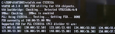

Edit2: Good news about OC. I have CY28316 PLL chip. So all frequencies are available. I wonder if it possible to mod bios...
