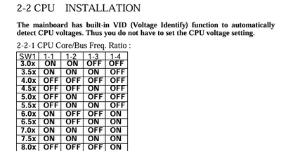

Reply 6 of 19, by clownwolf
That brings us back to the motherboard problem right, It cannot go over 8x multiplier, so maximum is 800Mhz. Unless I am misunderstanding things and there is a way to increase it further?
The attachment Screenshot 2025-04-08 184636.png is no longer available
Reply 7 of 19, by Ozzuneoj
clownwolf wrote on 2025-04-09, 06:33:
Unless you have an engineering sample processor, a Pentium III will always run at it's original multiplier regardless of what the board supports, because they are multiplier locked. If anything, the board's BIOS may report the wrong processor or speed, but a PIII with a 6x multi will always have a 6x multi. So, no matter what the board jumpers are set to, you will have whatever multiplier the CPU was built with. The multiplier jumper only pertains to unlocked chips and will do nothing at all with a PIII installed.
There may be other exceptions, but this has been my experience with them. On one hand it is nice because you generally don't have to worry about whether a board supports a certain speed of CPU as long as it supports Coppermine in general. On the other hand, it makes a PIII a lot less flexible for underclocking (for playing speed sensitive games) compared to a processor with an unlocked multi.
And, you may have figured this out by now, but this is exactly why a PIII coppermine with a 100Mhz FSB is so much more expensive than a 133.

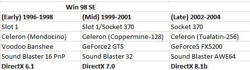

Reply 13 of 19, by clownwolf
After several days of thinking about the overall costs of Pentium IIIs, I think I will just focus on the Celerons of this era (Win98SE).
Considering the motherboard itself, I will just stick a Celeron-Mendocino on this one to avoid potential headaches. I already have plans for the next 2 Celeron projects (Coppermine-128, Tualatin-256) after this.
The attachment Screenshot 2025-04-13 140627.png is no longer available
