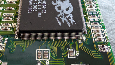

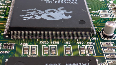

Hello, it took me 2 months to get this old voodoo card from Europe and of course there are issues.
Whats happening?

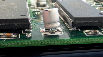

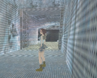

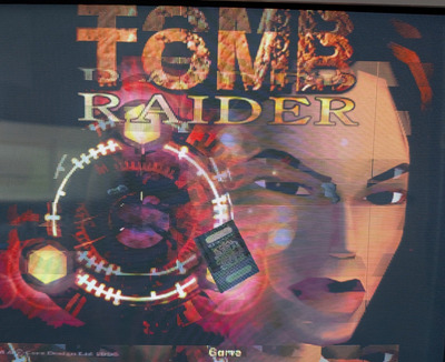

Computer freezes (e.g. 3dmark99 shows test screen and nothing after) or in the best cases generates messed up textures (attached photos of TR 3dfx dos demo)

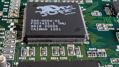

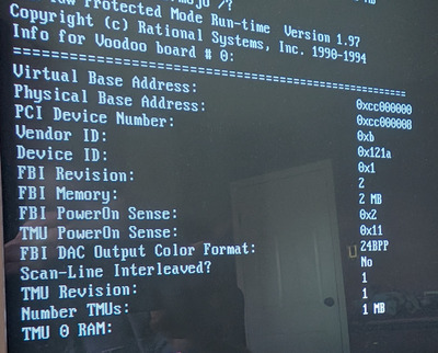

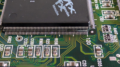

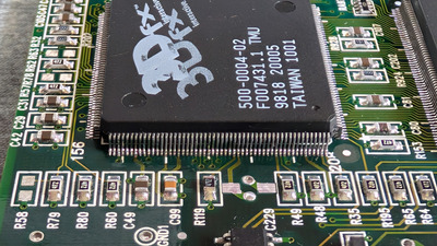

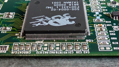

I dont see any physical damages on the card itself, but mojo shows only 1MB for TMU and I guess this is a good starting point to point towards a hardware issue.
Tested on 2 different machines (details in my signature) - exactly the same behavior. Tested with different drivers (windows default and most recent reference driver) and still the same. Fact that TR 3dfx dos demo also has issues kinda rules the driver out
At this point I'm looking basically for a confirmation of someone smarter than myself this is hardware issue and I should look for people able to fix it (and maybe someone worth recommending in Ontario)
