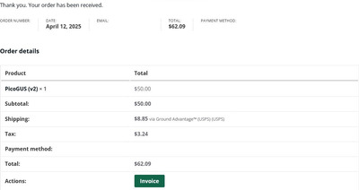

After much consideration, perusing this thread, and arguing with myself back and forth far longer than should've been necessary... The deed is done.
I've decided to replace the AWE64 Value and Opti 82C920 in my DOS 6.22 build with the PicoGUS. The wide range of games I'm using on that system would benefit from having GUS/SB/AdLib support to pick from on the fly. Also, much easier than running multiple cards (and cheaper). Lastly, I just want to play with it! Don't get me wrong, I love the AWE64 and Opti, but the PicoGUS seems like it will make life a bit easier on that build. We will see.
Wish me luck! 😀
