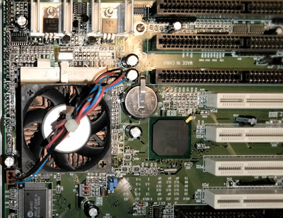

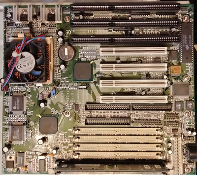

Reply 209 of 223, by sizzlinbeef
Chkcpu wrote on 2025-04-15, 14:23:
Hi sizzlinbeef, […]
Hi sizzlinbeef,
The P5I430TX-250 board comes in both a SpeedEasy and a non-SpeedEasy version. I understand you have the SpeedEasy version without the JC, JV, and JS jumpers?
I don’t know if these early Titanium I boards use a DC-DC Converter IC like the Raytheon RC5041M to control the Vcore voltage, or if a discrete circuit with resistors is used.
Can you make a high-res photo of your motherboard so I can see what kind of circuit is used?
These earlier boards often use linear regulators with discrete components to control the voltage to the CPU. If this is the case on your board, then only a hardware mod of an interposer can get you Vcore voltages below 2.8V.
Cheers, Jan
Yes, it's the SpeedEasy version.
vGKXsn5
Nl65uRX
7rMOp3M
FW8Z5hy
KEnD0x7

Reply 212 of 223, by Chkcpu
Thanks for the clear pictures!
First thing to notice are the two power transistors TIP120 and TIP102 with a big heatsink, and the absence of inductor coils. This means that this board has a linear power regulator circuit for the CPU, instead of the more efficient switching power regulator as used in later socket 7 boards, like the QDI Titanium B series.
Handling power for a Pentium-MMX/233 is usually the upper limit for these linear regulators.
Secondly, comparing your pictures with the Titanium I picture of the non-SpeedEasy version on TRW, I notice that the ICs U14, U22, and U13 are now present. Also 3 transistors, near the heatsinks of the two power transistors are added on your board.
Clearly these components are for the BIOS SpeedEasy control of the 11 missing jumpers!
U14 and U22 are DM7406’s and house 6 open collector buffers each, probably used as electronic switches to replace the jumpers.
U13 is an LS174 with 6 D flip-flops to latch the data for the electronic switches. But I see no DC-DC converter, normally associated with switching power regulators, for wider control of the CPU’s Core Voltage.
I was hoping to see a switching mode power regulator on this Titanium I SpeedEasy version, but due to the hardware constrains of the linear regulator circuit, modding the Titanium I BIOS for additional Vcore support is unfortunately not possible.
Regards, Jan

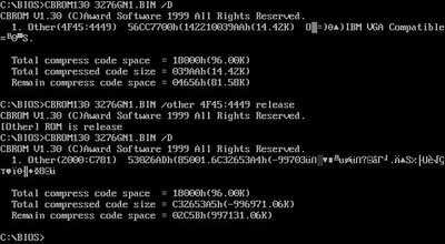

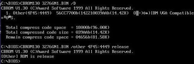

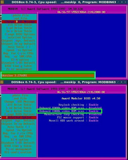

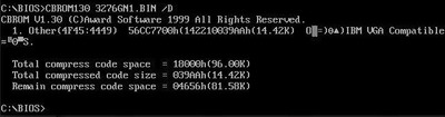

Hi, Jan!
The BIOS is for FIC 486-GVT-2 motherboard and I got it from TRW site - "beta BIOS (Y2K fix) + VGA BIOS" after I read the thread with the topic about the BIOS updates for this very same motherboard. As you can see, this 128 kB Award BIOS ver. 4.50 contains optional VGA ROM which is redundant for the FIC 486-GVT-2 motherboard and our fellow forum member scorp (Necroware's YT channel owner) just cut the 128 kB "3276gn1.bin" BIOS dump file in half leaving only the second part with the "core BIOS". But there are some hardware problems as seen in the comments left from other users who have tried it.
So I decided to try something else - to remove the redundant optional VGA ROM by using CBROM.EXE. The only problem is that all of the oldest CBROM versions that I have (1.30, 1.30C and 1.32) "see" this optional VGA ROM as "other" instead of "vga". Here is the example with CBROM ver. 1.30:
The attachment CBROM130_option_VGA_ROM.jpg is no longer available
Anyway, I proceeded with option VGA ROM removal by CBROM:
26.74 KiB
408 views
And the final result is this:
35.57 KiB
408 views
I also reproduced the same procedure using CBROM versions 1.30C and 1.32 and they gave me exactly the same binary matching BIOS dump files.
I've opened the BIOS the MODBIN ver. 4.50.63A (from 1997) and everything is OK, except that I noticed one redundant setting "Onboard C000h video ROM scan: Enable" which I changed to "Disabled" (as seen in other Award 4.50 BIOSes for motherboards without integrated video):
58.69 KiB
408 views
I have a spare 128 kB Winbond W29EE011 chip, so I hope I'll find time during the weekend to test my modified version. I'm attaching my modified 128 kB BIOS version of "3276gn1.bin" with removed optional VGA ROM in a zip-file, if you want to see what could be possibly wrong with it. Mind that I also made some minor BIOS menu settings tweaks and changed the BIOS message string:
64.8 KiB
408 views
All the best!

analog_programmer wrote on 2025-04-16, 22:03:
Hi, Jan! […]
Chkcpu wrote on 2025-04-15, 14:39:
Hi analog_programmer, […]
These socket 3 Award v4.50(G) BIOSes are usually uncompressed, so CBROM won’t work on these. But you write that it is a 128KB BIOS from 1997 and this puts this BIOS into the compressed BIOS era.
Can you upload a dump of this BIOS here, so I can take a look at this enigma? 😉
About MODBIN v4.50.80a, I’ve used it successfully on all uncompressed and compressed Award BIOSes from the 1994-1999 time period.
Jan
Hi, Jan!
64.8 KiB
408 views
58.69 KiB
408 views
35.57 KiB
408 views
26.74 KiB
408 views
I’ve looked into these 486-GVT-2 BIOSes, and found that FIC was up to its usual tricks again. 😉
With many of their Socket 7 BIOSes, they often made a small (Y2K) fix, years after the last BIOS update and slashed a 1999 date on it without updating the BIOS core to the 1999 standard. So these “BIOS updates” were in essence still a 1996/1997 BIOS with the limitations of that time.
I found they did the same with this “1997” 3.276GN1 BIOS. This BIOS is internally still an Award 4.50G 1994/1995 BIOS, and is completely uncompressed.
That’s why cutting off the first half of this 128KB BIOS file, that only contains the VGA ROM, worked without problems on the 486-GVT-2 board, as scorp demonstrated.
As the CBROM tool only works on the compressed Award BIOS, it can’t be used on this uncompressed 3.276GN1 BIOS. That’s why you saw a very strange CBROM ouput when you attempted to release the VGA ROM.
Because the BIOS is uncompressed, there is no LZH header to be found and it is funny to see that CBROM tried to make something of the beginning of the file and indicated the “IBM VGA Compatible” string as original filename of this “other” component. 😀
When comparing your 3276gn1_M-mynovga.bin with the original 3276GN1.BIN, I found that the first 32KB containing the VGA ROM was completely scrambled in your modded BIOS. Luckily the rest of the BIOS was not touched by CBROM, when you attempted to release the VGA ROM.
So your “mynovga” BIOS will probably work normally, however the VGA ROM is not in the way and you only had to Disable the "Onboard E000h video ROM scan:” in MODBIN.
This will effectively cause the onboard VGA ROM to be never called, so it can’t interfere with the VGA BIOS on the graphics card.
Note that the "Onboard C000h video ROM scan:” setting in MODBIN can be left Enabled.

Hi! And thank you very much for your detailed analysis of this Award BIOS, Jan!
I suspected that something's wrong with all the "garbage" given by CBROM when reading the contents of the BIOS (CBROM /D). But for the other "ballast" left when VGA option ROM was removed by CBROM I thought - maybe this is some useful code from another option ROM left. Also I had doubt, that these old versions of CBROM are the main culprit for the "garbage" displayed (because of this now I have a pretty big collection of CBROM and MODBIN versions 😀 ).
Oh, my goodness... These FIC's tricks with BIOS core versions are sick! Now I'm wondering why FIC's motherboards are so highly valuable, if this company had such a problems with their BIOS updates, with the information in their user manuals (for example the manual for this mobo lacks any settings for other CPUs except for intel and Cyrix 486) and their technical support in general. Ok, the quality of their production seems to be above the average level, but this doesn't justify their high reputation in terms of all the other problems caused by their bad technical support.
So, basically scorp's 64 kB BIOS no-VGA BIOS is Ok regardless of "Onboard C000h video ROM scan: Enable" setting is left untouched. It turns out that this is just a very bad beta BIOS update for the 486-GVT-2 board (maybe it works more stable for some of the other models boards from compatibility list given). I'll update my 486-GVT-2 to BIOS version 3.07G if I manage to dig up some 64 kB compatible BIOS chip as it currently has some OTP-ROM with BIOS version 3.03G. Or maybe I'll left this board as is and get rid of it, 'cause I really don't like it for some unknown reason (just a feeling) from the moment I got it in my hands.
You saved me a lot of lost time for tinkering with this FIC 486-GVT-2 BIOS and motherboard, Jan!

Reply 219 of 223, by Horun
analog_programmer wrote on 2025-04-21, 00:35:
Because FIC made very good motherboards, generally very stable, and back then (early -mid 1990's) they would respond to support emails.
added: the 06/16/97-VT82C486A-214L2000-00 BIOS (Y2K fix) + VGA BIOS is not from a real 486-GVT-2, is for the 486-GAC-V which due to same chipset TRW decided to include it in the 486-GVT-2.
There never was any video on a 486-GVT-2, not sure why they added it for it without some major notations. Also the board has no VRM so no 3.3v cpu's DX4's, back then Intel and AMD DX and DX-2 used same settings iirc
