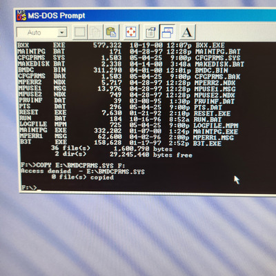

Reply 89 of 98, by JonnyQuest
I get this when I try and copy the file to my sd card?
Is there another way?
Reply 90 of 98, by JonnyQuest
I think I got it.
I was trying to pull that sys file from the old DOM that didn't work.
Way back when I started this thread I was able to copy that complete DOM to my desktop in W10. I transferred that whole backup to a USB stick. I had purchased a working W98 computer, put that USB stick in W98... Dos prompt.... then I was able to copy that single file to my SD card.
Put the SD card into my Bridgeport CNC... and it seems to be working with the correct sys file for this machine now!
I have some testing to do... but it does seem to work.
That was an effort. Wow. Thank you guys. I have another question.
I would like to make multiple copies of this SD card now.... so they are plug and play. What would be the best way to do this? Is there one single command to copy that will accomplish that?
