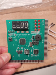

Reply 3 of 20, by zami555
douglar wrote on 2025-03-06, 19:51:
That seems like an odd coincidence. Sorry if this sounds condescending, but I gotta ask: did you orient the cards correctly? Rear towards the rear ?
A really valid point. On my card there is even a "REAR" written on Silk Screen. My card must be rotated when moving from PCI to ISA and in the end LED display is oriented in other direction
Edit: please refer to attached real photo of my POST card. It works both in PCI and in ISA

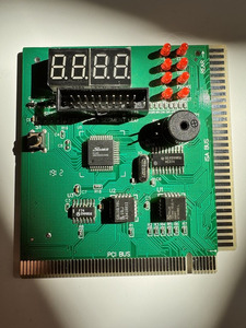

Reply 4 of 20, by Cosmic
I have a Kingwin CMBA-4 card. Looks like the chips on these POST cards varies a lot. My card came with documentation and a photo of the card which has an Atmel chip in the center, whereas the actual card has a SyncMOS 0109 SM2965C40Q chip.
Photo of my card attached, the ISA traces are connected and it works fine with PCI and ISA. As a bonus my card also has a header for an external 8-segment display so I can watch the codes from outside the chassis.

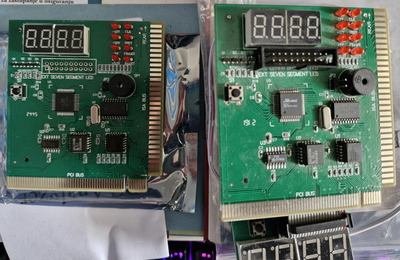

Hi, i need to open this thread again. I just received another Analyzer card, and i'm having the same problem. It works normally on PCI slots, and it won't show anything on led screen on ISA slots! Only voltage leds are working when inserted in any ISA slot (tried on 4 different motherboards)!
Can anybody give me a link, or sell me analyzer card that actually work on ISA slot?
I have add the pictures of last two cards i have bought that shows nothing on diagnostic led ( - - ).

Reply 10 of 20, by weedeewee
butjer1010 wrote on 2025-04-22, 09:25:
I have a similar/identical one to the photo you posted and for me it works on ISA.

Reply 11 of 20, by cyclone3d
Sounds to me like the BIOS is not initializing at all. Either chipset or BIOS issue most likely. Could also be RAM.
Are you getting any PC Speaker beep codes?
Have you tried it on a working motherboard with ISA slots?

Reply 12 of 20, by butjer1010
cyclone3d wrote on 2025-04-22, 16:45:
Yes, i was testing those cards on working motherboards (486, pentium), with ISA slots
When i insert them in PCI slots, everything is ok, i get codes on lcd display, but when i insert them on ISA slots, there are only voltage leds that are working, and there is nothing on lcd display
Reply 13 of 20, by konc
Do we know where these cards get their power from for their ISA part? Could it be the -5V pin? I can't think of anything else that makes sense after reading what OP has tried.

Reply 15 of 20, by mkarcher
konc wrote on 2025-04-23, 09:56:
I have that card as well. I guess half of the retro system builders on VOGONs have a copy of that card. The card is a 5V only design, both for PCI and for ISA, so missing -5V is not supposed to hamper ISA operation. As the OP clearly stated that the LEDs are lit, I guess we can safely ditch the theory of the card being plugged in the wrong orientation. When using the card on the ISA bus, you should be aware that the LED labels are not accurate. The -5V supply lights the 3.3V LED (as there is no 3.3V supply on the ISA bus, it makes sense to re-purpose that LED), and the FRAME and IRDY lines are some ISA activity lines. IIRC someone posted on VOGONs which ones, i think one is /MEMR to indicate access to (ISA) memory, with the intention to show access to the BIOS ROM, and the other one might have been /IOW.
Thus, on an ISA system with this card, you expect all 4 voltage LEDs to be lit (no 3.3V if -5V is missing), the CLK LED to be permanently lit, the RESET LED to be lit for a fraction of a second after power up, and also during press of the reset button, and FRAME/IRDY happily flashing during POST. Also, you expect some POST codes to appear.
I can't come up with a reason why the cards are not working on multiple ISA mainboards. It's not impossible that these cards are now produced with a different firmware than the earlier look-alike cards, and the new firmware doesn't work on ISA. On the other hand, having cards both with the Atmel and the SyncMOS microcontroller with both not working makes the "new firmware" theory unlikely.
