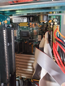

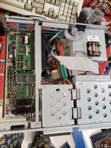

Reply 20 of 41, by Wzrd
Yep that's the one. All the way down to the stock AA batteries 🤣.

Reply 21 of 41, by Horun
I see your's came with a Trident 8900 ISA video card same as mine. Curious if yours had a SX or DX cpu. Mine had DX but also the Mathco socket was soldered where on your board it was missing. Just curious. Mine has the original ST3283A Seagate HD which still works ok. Most of the directories are dated 1992 except a few, so am assuming it is the original.
Ok tried four different cache setups, one told me 256k cache at end of POST but hung running cachechk. The others simply did not work, either did not show or hung before end of POST. Unfortunately the manual is missing some information. With the board having 4 main cache sockets and two "tag" (or one Tag and one for parity, since manual pages mention 32x8 and 32x9) have yet to get a cache chip setup to work properly (and used known good cache chips, two sets off perfectly good working 486 boards). Back to square one with no cache and runs fine.

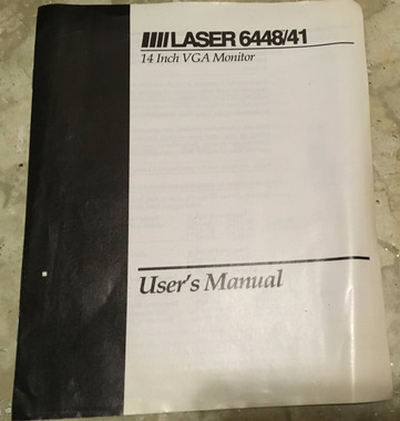

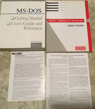

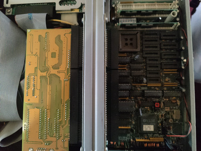

For historical sakes, Here are a couple pictures of some manuals from the 286 and 486 variants I have and kept since mid 90's (yes am a packrat)

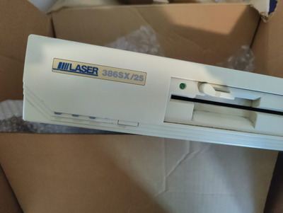

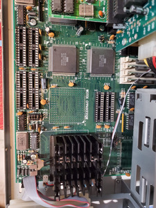

Reply 33 of 41, by shortformernie
For folks curious about VTech and Laser, I just acquired a Laser 386SX/25, which is the exact model I had when I was a kid. This model has just three spots for drives—3.5 and 5 1/4 floppies and a hard drive.
Still digging through it but the machine turns on, though no video at this time. (I’m sure I’ll get that figured out soon enough.)

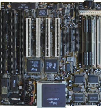

Reply 36 of 41, by BigDave
I keep finding these old, but very interesting topics, but this one almost brought a tear to my eye, especially the photos @RetroSpector78 had posted of his Laser 386 PC, as my first IBM compatible PC computer, was infact a VTech Platinum system. Unfortunately, whenever I tell anyone I had VTech PC, they immediately think of those kids toy computers that were very popular and laugh! but no, it was a Win 95 PC System which I received as a very extravagant 1996 Christmas present from my wife, costing £1299 (around *£2400 today) from a company selling VTech PC systems in the UK called Crown Computers.
I can't find any pictures, but the AT Desktop case style and keyboard looked identical to the Laser 386 system above, but it came with a generic mouse, and a Tatung 14" CRT monitor, which looked like this one:
?u=https%3A%2F%2Ftse1.mm.bing.net%2Fth%3Fid%3DOIP.gz7QhhLdaswneq3BaSC8jQHaHJ%26pid%3DApi&f=1&ipt=d3dccaea78529d9931b4c472af3489d296009057656172fd49367049a02a4025&ipo=images
It had Windows 95, so as recommended for performance, the base memory was upgraded from 8mb to 16mb. Despite the Win95 compatible logo stickers, I found most games of that era were still largely DOS based, which at times were a PITA to get working, but was all part of the experience then, and helped me learn a lot more than I would've done if things had simply worked first time. Like many computer systems of the 'Multimedia' era, it came with a FREE CD ROM software bundle, adding perceived value.
OEM version bundle comprised: Microsoft Windows 95, Lotus Smartsuite 3.1, Microsoft Dangerous Creatures, Microsoft Encarta '95, Microsoft Works 3.0 including Money 3.0, and Microsoft Golf 2.0
Main specifications: Windows 95 desktop PC, VTech / PC Partner intel 430VX Socket 7 motherboard, Intel Pentium 120mhz CPU, 1.1 GB Hard Drive, 16 MB RAM (2 x 8mb 72pin EDO SIMM memory), Trio S3+ 1 MB PCi VGA, ESS Audiodrive ES1868 ISA soundcard, 8 or 16x CD ROM.
Over time I upgraded to a 200mhz CPU, but eventually, only the case & PSU were original, as I upgraded almost everything, Win 98SE, Gigabyte GA-5AA motherboard, AMD K6-2 500mhz CPU, 128 MB PC100 DIMM RAM memory, Western Digital 40GB HDD, NEC CDRW, and finally a 3D Graphics Blaster Exxtreme (Only because the Permedia 2 features looked impressive on the box, and it was the only card under £100 in my local PC World). I ended up using it for an arcade project which got sold, and by then had an Athlon system I'd built.
I wanted to get an old PC, and initially hoped to find a VTech like I had, but haven't seen one on eBay in years or anywhere else, possibly due to Crown Computers going bust. I've ended up buying a Packard Bell which I've added details and pictures of in Post your Packard Bell computers here!. It's a bit a newer being from 1998, but I've been fascinated with Packard Bells of that era for a few years anyway, so decided it will do me perfectly, and still allow me to enjoy all my old games on real vintage socket 7 hardware.
If anyone has any pictures, adverts or information on these VTech PCs, I'd love to seen them.
BTW, I still have the ES1868 Windows 95 driver disk from the old VTech which I can image if anyone needs it.
*According to Bank of England inflation calculator.
VTech intel 430VX Motherboard
