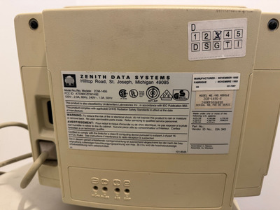

I have picked up a used Zenith Data Systems ZCM-1495 CRT monitor in a flea market for 20 euros.
But I am unable to make it work with any of my retro computers.

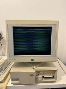

It states that it is a VGA monitor but it is constantly out of sync.
Even on an old 386 with ISA 512 kb VGA card in BIOS mode
I thought that BIOS screen was always default 640x480. But it still shows garbled signal.
Maybe I am missing a pin in the cable ? But does not look that anything is broken.
Anyone has any ideas or tips what to check without opening the case ?

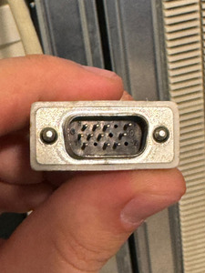

Yeah, I can confirm that the picture looks like the horizontal sync is not working. If this monitor is a fixed frequency VGA monitor, it's quite likely that the capture range of the horizontal oscillator is quite small. Standard VGA is at 31.5kHz, and it's perfectly valid for a VGA monitor to not sync if the frequency is below 31.0kHz or above 32.0kHz. The monitor likely has a control for the basic tuning of the horizontal oscillator (sometimes called "H FREQ" or "H HOLD") inside the monitor, which might be de-tuned. Furthermore, if you open the monitor, you should check continuity from the HSYNC pin (pin 13, the center pin of the bottom row) of the video connector you took the photo of to the HSYNC input of the monitor electronics.

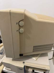

I had one of these flat Zeniths back in the day, but not this model. It produced a very pleasant image, but it was also one of my first experiences of a monitor failure. Of course this could be because I bought it used at a computer show, there's no telling how many hours it had when I got it
Reply 6 of 7, by pentiumspeed
Difficult to repair due to house part numbers and yes, was high failure rate. Even back in the day, seen 1 or 2 and they were new back then. I was working at university that bought Zenith stuff.
Some of them had that fan to cool the internals.
