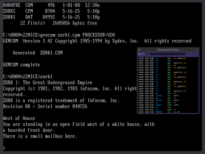

I've implemented support for the V20's 8080 mode.
Here's the CP/M-80 version of Zork I running in the 22nice CP/M emulator using PROCESSOR=V20.
The attachment 8080_zork.png is no longer available

The disassembly shows 8086 registers, instead of 8080 ones. Is that intentional?

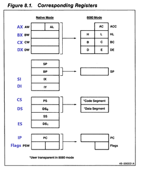

Well, the V20 doesn't have a unique set of 8080 registers - they are mapped to the existing 8086 register set.
The attachment emulation_registers.png is no longer available
The CPU status window isn't going to switch to 8080 register names in emulation mode. So it's sort of a matter of deciding what is more confusing to look at.
That's interesting that BX/CX/DX are mapped to HL/BC/DE respectively because those are the same names that Intel's 8086 patent gives to those registers in their microcode snippets. I didn't realise that mapping was an (apparently canonical) 8086/8080 mapping.
