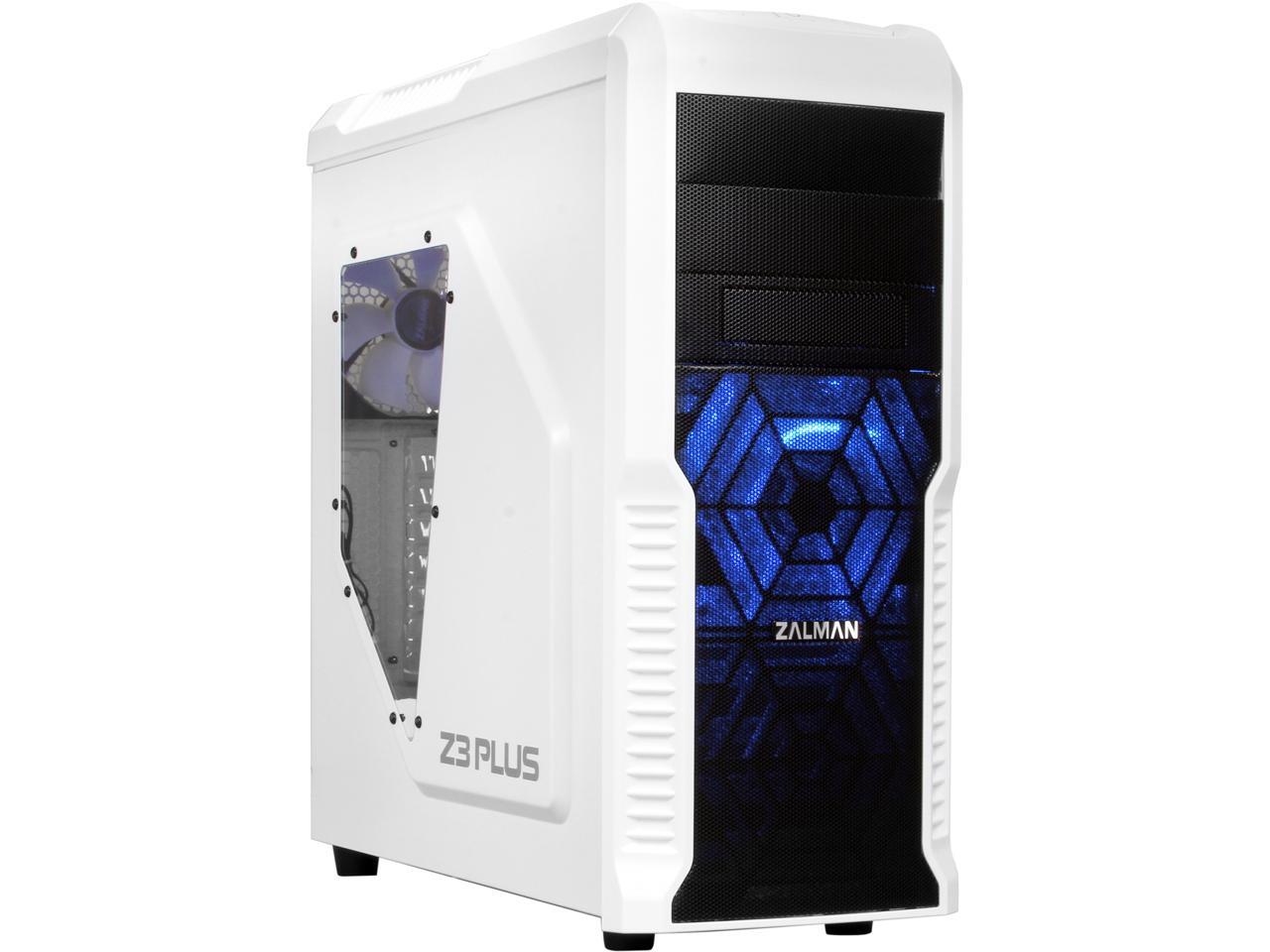

Reply 23 of 49, by AlexZ
Asrock AM2NF3 cannot be obtained anymore but is an interesting piece for retro rigs. I have checked out official drivers for Asrock K8NF3-VSTA and Gigabyte GA-K8NS but Windows 98 drivers are not available. They can only be downloaded from theretroweb. Given that VIA tends to have problems with AGP memory being 0 (except for very early bioses) nForce is probably a better choice. Anything AGP is only suitable for Windows 98 and will struggle in Windows XP.
My Athlon64 754 is PCIe version (Gigabyte GA-K8NE) and thus is still quite usable for Windows XP.
Higher TDP can be easily handled by using cases from 2010-2015 like Zalman Z3 plus. Those are very cheap, mesh cases, have front, back and top fans, PSU at the bottom. Very suitable for Pentium III, Athlon XP, Athlon 64, Pentium 4. One of the last mesh cases that still have FDD slot.
Zalman Z3 plus - https://c1.neweggimages.com/ProductImageCompr … -235-046-02.jpg
I plan putting my PIII into Zalman Z3 plus.
Athlon 64 is in Zalman Z9 (see https://www.newegg.com/p/N82E16811235026 ) with mesh on side panel. One bottom fan, one front, one back, two top fans. Very suitable also for AM2 and AM3.
