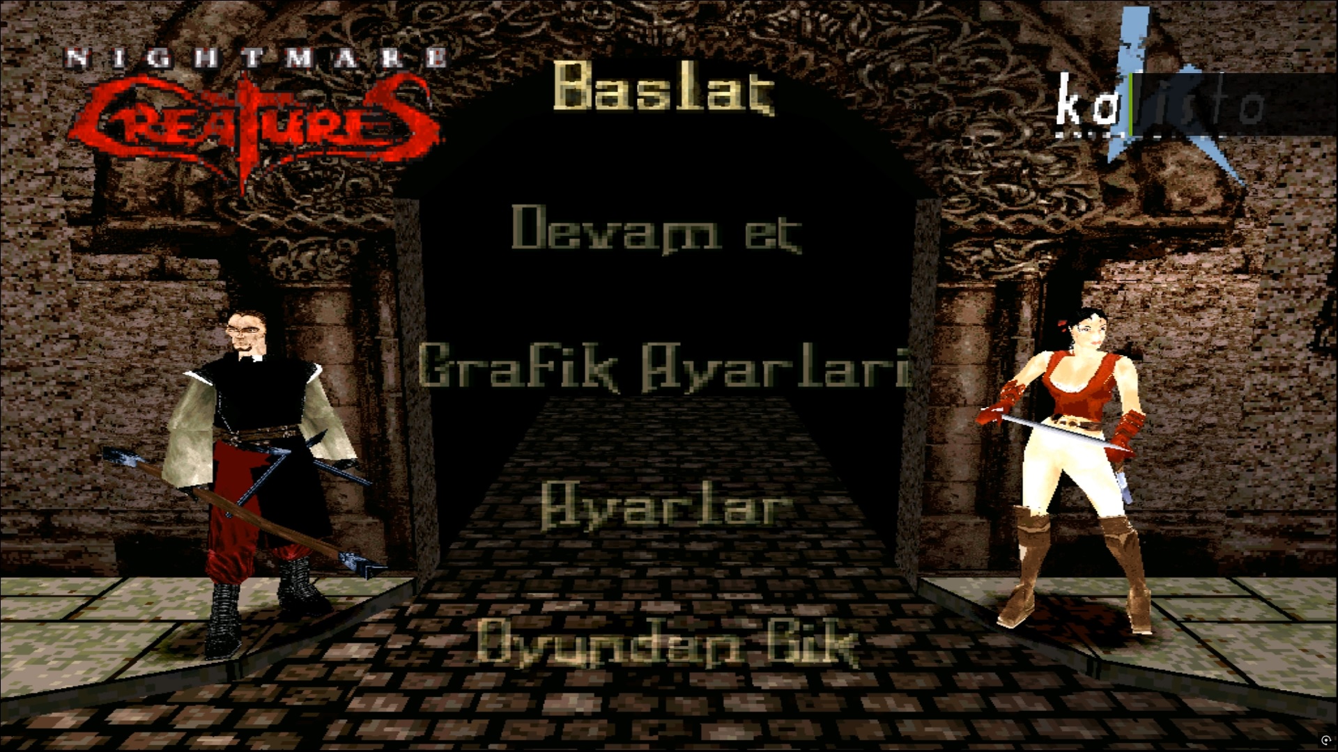

Hello, I formatted last night due to nonsense viruses and slowing down the computer, I was using windows 10, I installed windows 10 again. I use dgvoodoo actively without any problems, but after the format, even the games I set before do not work, I mean, I did everything I could think of, the driver is up to date, dx is installed, vc redist is installed, so what could be the thing that requires it not to work? What could be missing so that the program that works smoothly does not work after the format. Thank you in advance for your support.

It doesn't matter which game it is, I already said in my post that I use it actively and I already have dgvoodoo configuration in many games, here I share the images before and after the format. as I said, I don't know how to overcome this problem.
Whatever happened after the format, whatever was missing, it doesn't work, as I said, I can't run the program that I never had a problem before the format.
Before formatting
https://resimyukle.app/i/pKqmikIU.jpg
After formatting
The dgvoodoo configuration is already in the game in short dgvoodoo is not working for some reason.

I tried all of them and the result is the same, normally in the output api section I was using Best available one to work on other PCs. but in the adapter use section in the dx11 dx12 subsection, all of them, but I tried them all to no avail.
I don't think it's the game's own configuration, I use dgvoodoo in about 60 or 65 games, all of them already have the configuration and none of them work, I uninstalled it and configured it from scratch and it still didn't work, it's a very strange problem, I've been using dgvoodoo for years and this is the first time I've encountered this problem.

Strange thing, uninstalled and reinstalled the driver and it worked.
