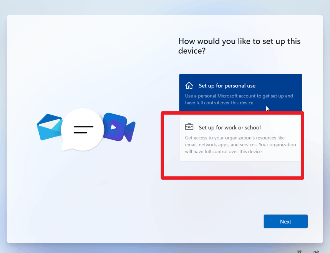

Reply 8 of 19, by wierd_w
I am unsure if it is even an option on Windows 11 Home, but if you select "For a school or business", and then select "Join an Active Directory Domain" during setup, it creates a local account. You dont have to provide domain info. It will work in workgroup mode, until you actually enroll it later.
7a481af3-ea98-4893-b91a-8f78468d7db8?platform=QnA
image2-jpg.40447
image3-jpg.40448
image7-jpg.40450
Reply 10 of 19, by wierd_w
Very unfortunate.
Even still, "Even on the Pro version", Microsoft *REALLY REALLY WANTS YOU TO MAKE AN ACCOUNT*
Note the many places it tries to misdirect you into creating one, and how it tries to gatekeep creation of a local account behind creating a domain account, despite these being very different things.
Its quite disgusting.
As for "Ways around it"
Aside from using Rufus to neuter that bologna at the gate, you can set up with a microsoft account, then boot up a linux live-usb, then use chntpw to forcibly enable the builtin local admin account, and set its password to <blank>.
Then, disconnect the internet, boot into windows, log in as this admin account, create a local account with the users and groups [neutered home version], delete the Microsoft Account based entity, shut down, reboot the linux live-usb, use chntpw to re-disable the builtin admin account, and pretend you did not have to jump through the hoops.
You will need a very good imagination.
