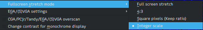

Hello all,
Pretty much the title of this thread. I can run 86Box under Windows 7, but I want the authentic 640x480 scanlines (which my Samsung SyncMaster MB1763 CRT can produce) when I run 86Box fullscreen.
The reason that I am asking for the XP is the fact that I would like to run 86Box in 640x480 resolution, and create older DOS bases virtual machines, and my Samsung SyncMaster MB1763 CRT monitor can produce nice looking scanlines under this resolution.

Reply 3 of 14, by C0deHunter
GloriousCow wrote on 2025-08-15, 17:49:
What's missing here is why you need XP to use your SyncMaster CRT. I assume it has a VGA connection. You could use a modern computer and an HDMI to VGA adapter or an inexpensive video card with a VGA out.
It's just the matter of convenience, although I have indeed thought of that idea myself. I have a very modern PC that is close enough to this old desktop PC, and I can use that.
My issue is the stretching of the image however. No matter which setting I use under 'Full Screen Stretch Mode', (or other settings under the View option menu), the text and images look a bit fuzzy)

The strange thing is the initial boot of the system (I am using an AOpen ZX6BC as motherboard) the BIOS text looks very sharp (can see the scanlines on the CRT) but as soon as it loads into the OS or asking for a boot disk, the image resolution changes into a fuzzy one.

Reply 8 of 14, by gerwin
C0deHunter wrote on 2025-08-15, 15:51:
There seems to be a discontinue on the XP binaries (as confirmed by the 86Box admin over at the Github) and I have asked him to kindly provide the XP binaries.
https://github.com/86Box/86Box/issues/412
Many thanks!
MinGW GCC v10.3 from 2021 can build Windows XP binaries just fine. I find that If you one uses it as a compiler on Windows XP; it will not add NT6 API calls, when linking to the common stock runtime libraries. Just that one needs to use an older libwinpthread-1.dll.
QT 5.6.3 is the last version to work on Windows XP. Any other dependencies will have their own compatibility situation....
PCem v17, from december 2020, runs on Windows XP.

Reply 14 of 14, by superfury
DosFreak wrote on Today, 10:25:
All,
This thread is about 86box on Windows XP, not yet another Windows 10 rant thread.
You're right. Sorry to get the discussion a bit side-tracked there.
Anyways, tried recompiling the latest 86box with XP settings yet? It should either support some kind of automatic build configuration that you can adjust or maybe some legacy stuff (like SDL 1.x or the like)?
Am not that familiar with 86box compilation. Perhaps look into the git repositories if you can find anything (configure scripts, autobuild and the like)?
Looking into the codebase (https://github.com/86Box/86Box/blob/master/CMakeLists.txt) it looks to be CMake-based, so if you've got your development environment setup (gcc+CMake, try MSYS2 for example. Then editing the CMakeLists.txt and add required flags for XP compilation.
Perhaps add (based on https://stackoverflow.com/questions/46724267/ … -march-hardware):
CHECK_CXX_COMPILER_FLAG("-march=i586  -mfpmath=387" COMPILER_SUPPORTS_MARCH_XP)
if(COMPILER_SUPPORTS_MARCH_XP)
set(CMAKE_CXX_FLAGS "${CMAKE_CXX_FLAGS} -march=i586 -mfpmath=387")
endif()
To build for Pentium CPUs with 387-compatible FPU (to prevent Pentium FDIV bug).
Or try "-mno-80387" instead of "-mfpmatch=387" for a software-based FPU solution.
No idea if it has any code depending on a specific OS though, you'd have to check that yourself.
