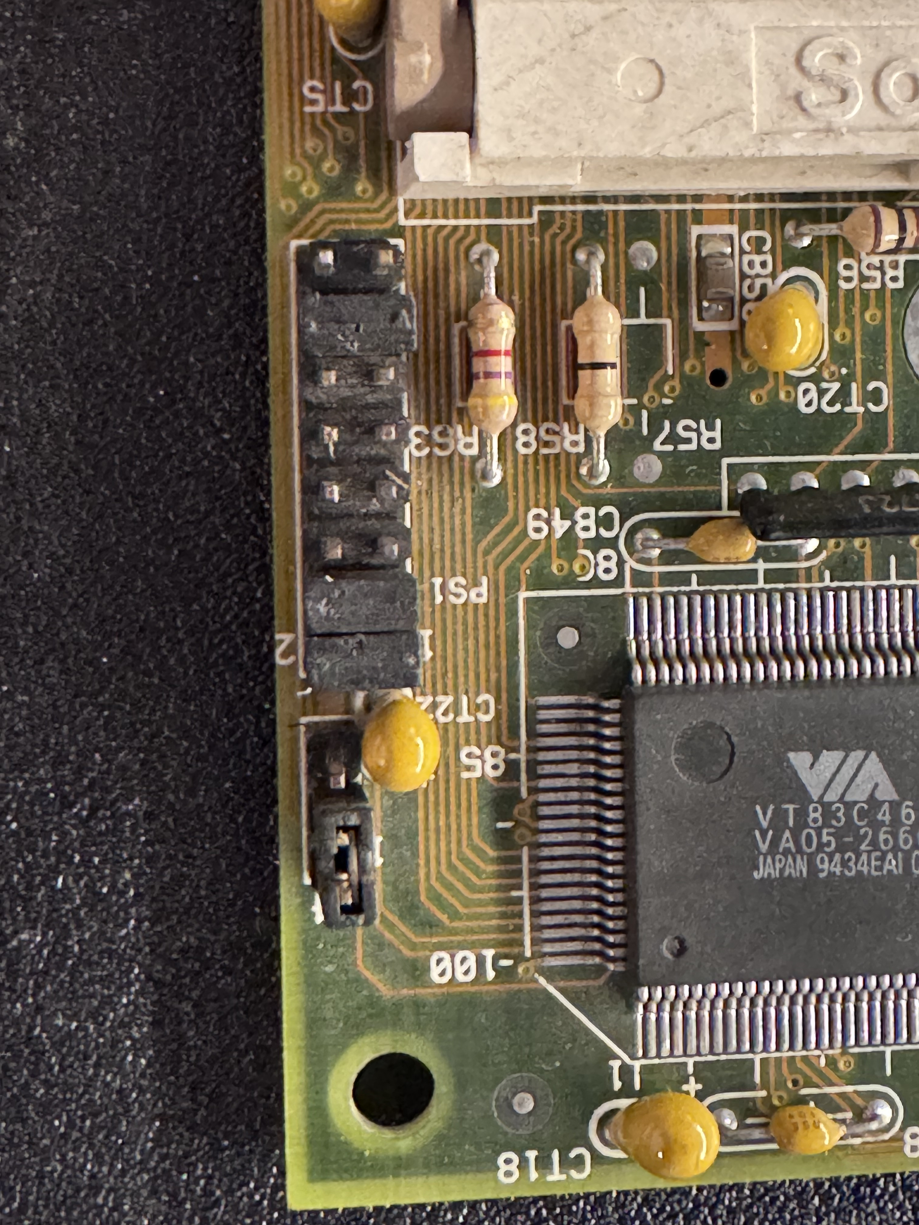

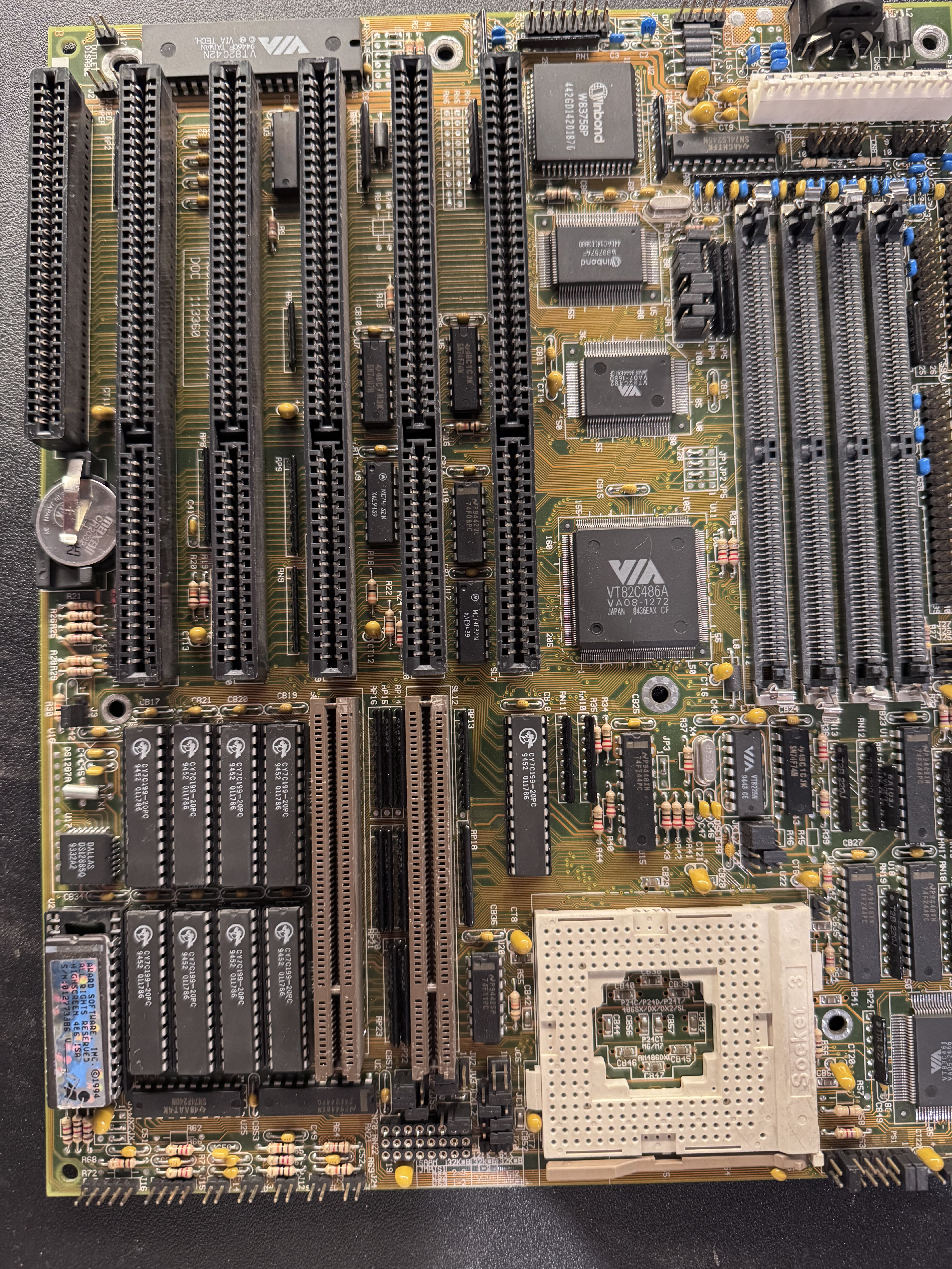

I have this motherboard:
4 8 6 - G I O - V T 2
The manual:
https://theretroweb.com/motherboard/manual/32544.pdf
Clearly says how to setup this cpu.

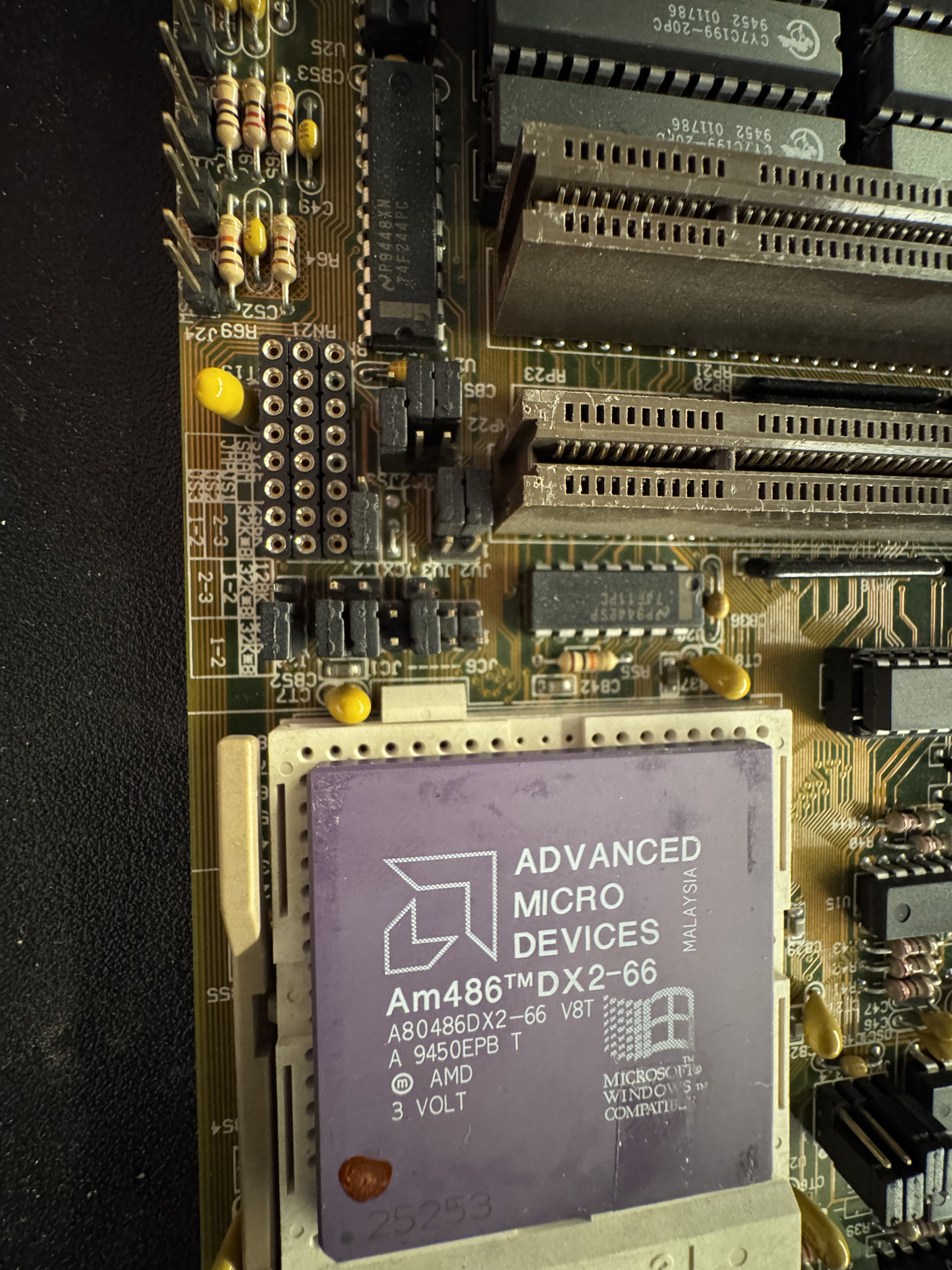

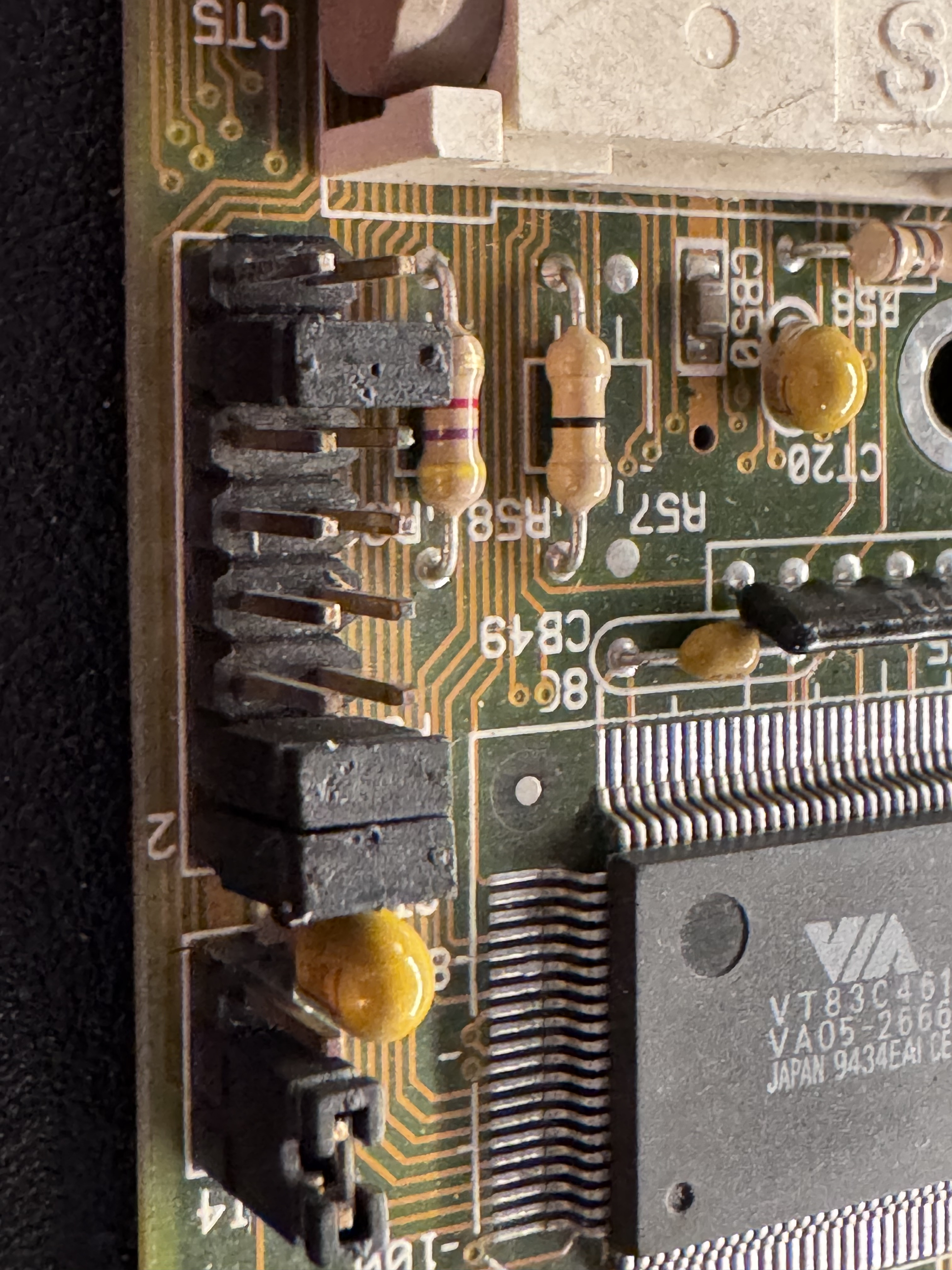

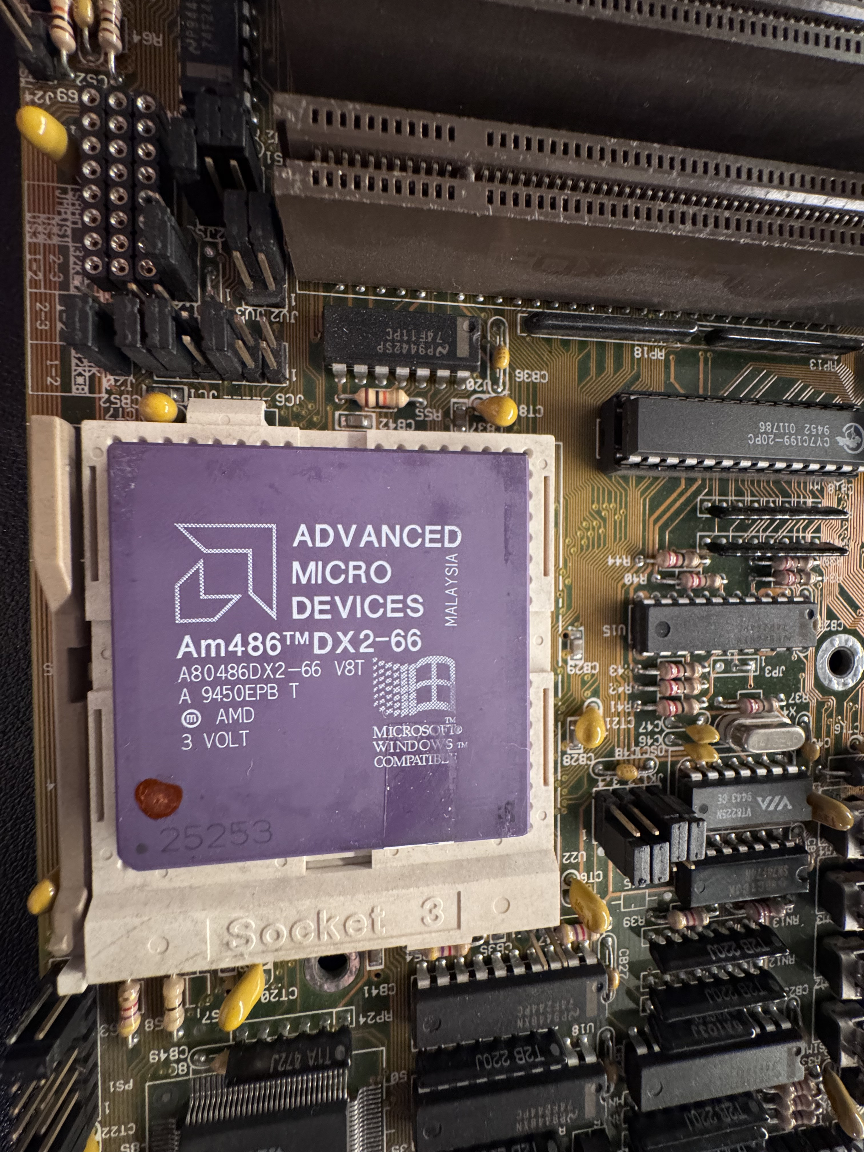

I set all the relevant jumpers for dx2-66 mhz cpu (33mhz, 2x multi) but i am unsure about setting voltage , supposed to be set on PS1 but i cant figure out what to set there.
Btw cpu is 3v, board offers 3.3v and 5v, is that ok?
See photos as well of current jumper config. The board wont even post. No beeps, nothing.

Reply 1 of 7, by mkarcher
Omarkoman wrote on 2025-08-29, 07:36:
3V is a short-hand for actually 3.3V or even 3.45V, so the 3.3V setting is the correct one. I'm afraid that "PS1 installed" means that you have to install a power regulator card into those pins. This regulator card (often, cards of this kind are called VRM: voltage regulator modules) is likely a proprietary card. There is a standard for Pentium/Pentium MMX voltage regulator cards, but I'm unaware of a standard for 486 voltage regulator cards. Unfortunately, this means you have these options unless you have that card:
  • Use this board ony for 5V CPUs. In this case, the card can be substituted by jumpers as shown in the document you linked
  • Obtain the 3.3V regulator card that fits this mainboard
  • Reverse engineer how the CPU power supply on this board is supposed to work, and design and build your own voltage regulator card
  • Do a limited reverse engineering to find out where the 5V I/O voltage pins and the 3.3V core voltage pins of the 486 processor are connected (5V I/O might be connected directly to +5V on the AT power supply connector or some pins of PS1 only, 3.3V is only connected to some pins of PS1), use an ATX power supply with an ATX->AT adapter and tap 3.3V from the ATX connector into the 3.3V pins at PS1.
With the jumpers set to 5V, you might fry your CPU, and without anything installed at PS1, the CPU is not getting any core voltage, so it will not work.
Reply 2 of 7, by wbahnassi
Put the multiplier to 1x and it should work. 2x is overclocking your CPU way too much and it will refuse to POST. The DX2 66's 2x multiplier is internal to it, so in the board if you put 2x multiplier it results in a total of 33x2x2 .. 132MHz.

Reply 3 of 7, by konc
The retroweb entry has multiple photos of the board, the regulator, and the board with the regulator installed to see what it looks like.
I don't know how feasible it is to find one, but I'd bet it's easier to just get and use a 5V CPU.
Reply 4 of 7, by mkarcher
wbahnassi wrote on 2025-08-29, 09:45:
That's wrong. The multiplier selection on that board does not affect the front side bus. It will stay at 33MHz no matter how you set it. The multiplier jumper just sets a pin for 486DX4 processors, which is used by those processors to choose between 2* (66MHz) and 3* (1000MHz) for their internal multiplier. A classic DX2 processor will just ignore that pin and use a fixed *2 multiplier, as you set. It will keep running at 2* even if the jumper is set to 3*. Newer 486DX2 processors contain the same die as the DX4 processors, so the die will support both 2* and 3* clock. I don't know whether Intel bonded the clock select input of that die to the CLKMUL pin or fixed the multiplier to 2* internally. Nevertheless, to be on the safe side, setting the clock multiplier to 2* instead of 3* for a modern DX2 processor is a safe choice.
Reply 5 of 7, by Matth79
The alternative would be an interposer adapter, which carries the CPU and a voltage converter. But a 5V DX2-66 shouldn't be that hard to find. If you wanted a DX4-100, 5V would require a DX4-100 ODPR (Overdrive Replacement)

I solved this problem by connecting an ATX power supply, it has a voltage of 3.3 V. I made an adapter and the board worked with a 486 3v processor.
