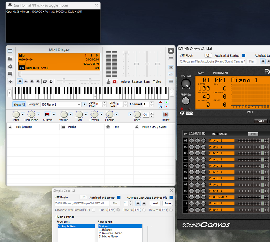

Reply 2344 of 2443, by Spesek
I know, I'm not using SCCore, but the Sound Canvas VA file.
But this is what I get:
The attachment scva.png is no longer available
And it's not like I can register it given that it's discontinued.
Yet foo_midi doesn't have any of these issues. It just works.
Reply 2345 of 2443, by Falcosoft
Spesek wrote on 2025-09-14, 17:26:
I know, I'm not using SCCore, but the Sound Canvas VA file. […]
Foo_Midi does not use the VSTi plugin at all. It uses the SCCore directly. I think Kode54 called it the 'secret sauce' or something like this. Your problem is definitely proper authorization related and has nothing to do with FSMP. All normal VST hosts would produce the same result.
Ps: I think the old offline installer of SC-VA is still available that has a time limit but at least produces sound.
http://cdn.roland.com/assets/media/zip/scva_win_trial.zip
