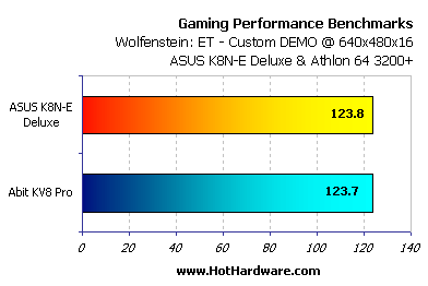

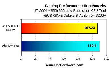

What a pity that the divine Abit did not make motherboards for the VIA K8T890
https://theretroweb.com/motherboards/s/asus-k8v-xe
And we will never know its strengths and weaknesses.
Although, in any case, this is exactly what an epic "battle" will look like.
And this will depend on the aggressiveness of the BIOS settings and the absence of errors.
This is not the era of Socket A/370 with a memory controller inside the chipset.
