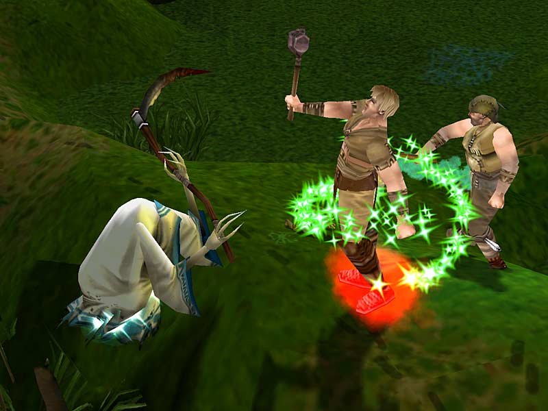

Evil Islands: Curse of the Lost Soul (from 2000/2001)
Never played this game, someone has and is it good?
https://www.metacritic.com/game/evil-islands- … -the-lost-soul/
More demanding game for RagePro,but it is supported,8MB 2xAGP please
I would try it @RageXL 8MB AGP (4xram-64bit) / RagePro cards 8MB AGP
Use faster CPUs, not minimal configuration @ 233 or 266MHz Celeron/P2
https://allods.gipat.ru/sites/evil-islands_.c … eng/faq_hw.html
https://allods.gipat.ru/sites/evil-islands_.c … g/settings.html
If ingame dithering settings does not work,try Rage2dev and Rage Pro Tweaker tools
ATi Rage128 / Rage128Pro is fully supported and runs well @ 32bit, best experience 😀
