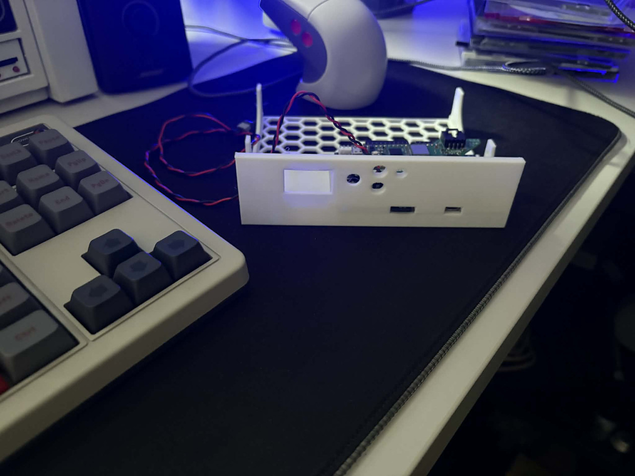

Reply 221 of 231, by buffi
I am very comfortable with SMD soldering and would love such instructions. Printed the carrier, so just waiting for the front panel now 😀

Reply 224 of 231, by buffi
Also, I'm a little curious how the carrier is supposed to be printed. I had the best result with printing it with the front facing panel face-down, and then using organic supports for the rest, but it doesn't really feel like it's designed for printing like that since there's just a lot of overhangs which could be designed to not need supports...
That's kindof true for printing it with uh.. bottom down as well though 😀

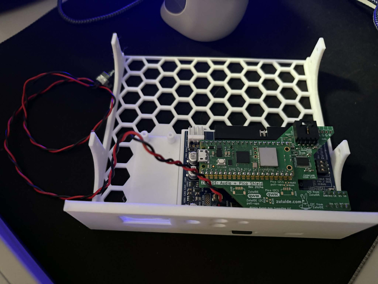

Reply 225 of 231, by buffi
... sorry for spamming but I can't seem to figure out how to edit posts on this forum.
Anyways, I was planning to modify the carrier a bit to have it more printable, but there's also some weird bugs in the model above, like the beam here is hollow, causing it to not print well.

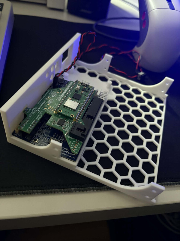

Reply 226 of 231, by aperezbios
buffi wrote on 2026-02-03, 17:43:
Before you do that, try this revised bracket design instead:
https://www.thingiverse.com/thing:7167806
Reply 227 of 231, by buffi
aperezbios wrote on 2026-02-04, 01:42:
This printed fine with faceplate down, and supports for the part in the far back.
I noticed that the side screwholes were smaller in this one, which caused the screws to not thread into them well, but found some other screws that worked.
