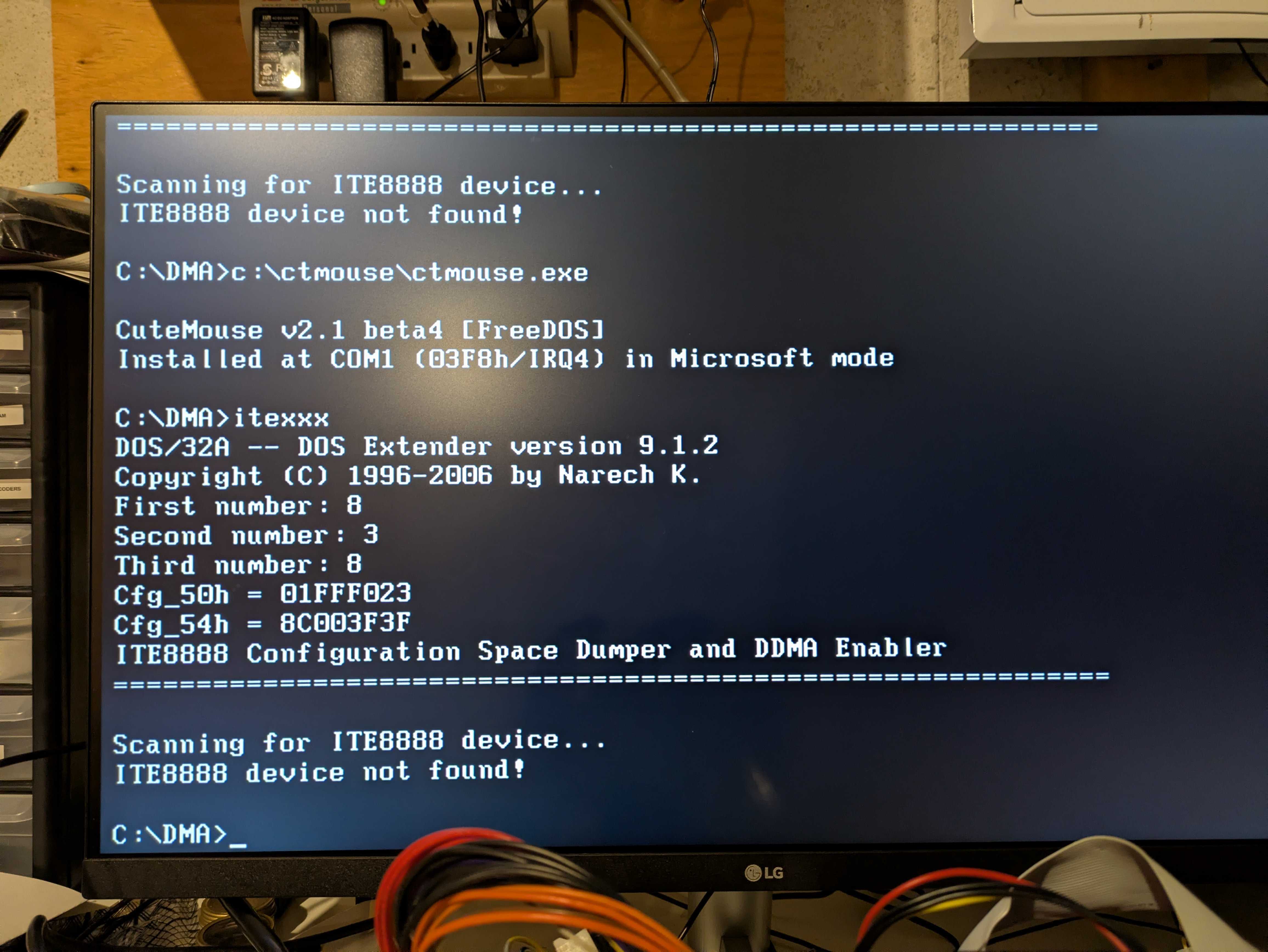

Reply 19 of 26, by hpxca
@KYA Thanks for writing this it's very interesting. I gave it a try on my Portwell PEB-7702G2A (https://portwell.com/pdf/embedded/PEB-7702G2A.pdf) but I didn't get very far. I disabled all the integrated peripherals on the PCI bus that I could (The AC97 audio, the USB 1.0/2.0 controller and both gigabit NICs) but still, it couldn't find the ITE IT8888F PCI-to-ISA bridge. I know the bridge works, with an ISA sound card in there I can get music, just no digital audio since DMA doesn't work (at least not without something like this perhaps)
Edit: I guess it's because it's the older ITE8888F instead of the newer ITE8888G. Might still work since as best I can tell they are very similar, but the current program doesn't recognize it.
