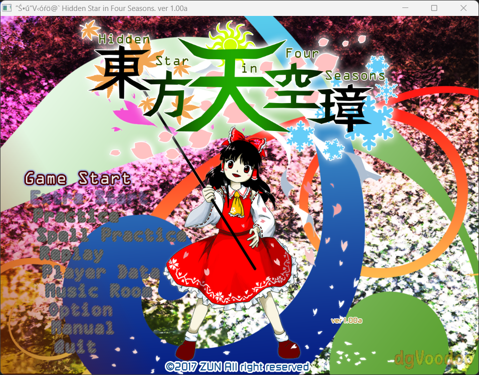

So I choose 960 x 720 to precisely upscale it to 1440p.
No matter what DPI scaling I'm using I always get this, even with native D3D9:
A part from the right and the bottom of the image is missing. Or maybe not because when I run the game in windowed mode (the first checkbox in the game options window) then the window content is the same as in fullscreen:
Also, fake fullscreen does not affect this behavior for me.
