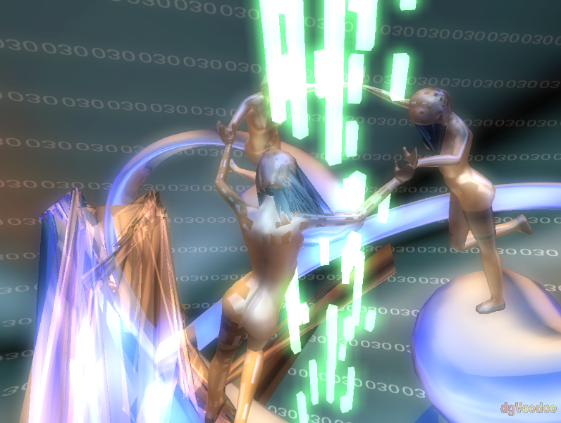

Reply 20 of 38, by Squall Leonhart
Dege wrote on 2025-04-22, 07:12:
It's because of this (at least I guess): F.E.A.R - Two remaining issues (well three) […]
Cambid wrote on 2025-04-21, 11:59:
Yes the glass can be fixed by actually fixing the shader (though CEnshine on custom edition or straight up hex editing the fx.bin on the retail version to use the correct sampler type). It's just that Dgvoodoo used to account for the stock shader being wrong but now doesn't. Not really a big deal though.
I changed the mismatching sampler behavior for the sake of FEAR, and to match the native D3D9 driver implementations (I looked at various vendors). And that fix went into v2.8.
Btw, are there other problems with dgVodoo besides the indicator and this sampler-mismatch thing?
Frankly, I'm getting lost in this Halo shader-mess. I don't even understand why there is no only 1 fix for the game, containing the fixed shader binaries with the modified sampler types (independently on D3D9 implementations). Maybe I should have made a patch for it myself.
Also, I suppose the game appeared correctly with the contemporary GPU it was written for, so if I knew what that hw was (XBox ?), I could put back the old sampler-mismatch implementation for one/some of the virtual cards.
Geforce 3 on Xbox
Geforce FX/Radeon 9600+ on PC

Reply 31 of 38, by Cambid
Dege wrote on 2026-01-02, 10:46:
I had a look into it earlier and I could reproduce it both with my NV 1060 and an AMD R7360 natively.
Though dgVoodoo still seemed worse, but I couldn't find a bug in mapping the z-values and the bias (according to the DX9 specs).
I'm not sure we're talking about the same thing here. I'm refering to this random texture corruption that happens sporatically. These random black rectangles that are not part of the bitmap that show up on some mip levels.
The attachment vlcsnap-2026-01-11-18h47m36s758.png is no longer available
Video example:
https://youtu.be/6_iG7frnkKc
The border colour issue is a strange one on Dgvoodoo because sometimes it works correctly and sometimes it doesn't, so I'm not really sure whats going on there.
I already understand that theres not much that can be done regarding the z-fighting issue.

Reply 33 of 38, by Dege

Reply 35 of 38, by Dege
Thanks, I'll look into it.
Reply 36 of 38, by Dege
Cambid wrote on 2026-01-12, 10:54:
Dege wrote on 2026-01-11, 16:06:
Ok, I see. Do you have a savegame for that location? I could have a look into it. Btw, is the border color not working at all wh […]
Cambid wrote on 2026-01-11, 10:58:
I'm not sure we're talking about the same thing here. I'm refering to this random texture corruption that happens sporatically. […]
Video example:
Ok, I see.
Btw, is the border color not working at all when it's not working or it just has component order problems that you mentioned?
This is a checkpoint just before that location. It's for the retail PC version with stock maps (not custom edition). To use it put it in "\My Games\Halo\savegames\"whatever your profile name is"\checkpoints\". I'm not exactly sure what the correlation is but I can farily reliably reproduce it here if I load up the level Keyes, run around for a bit, then load up that checkpoint on my 5700XT. I have a feeling it's GPU dependent as I can't reproduce it on my ancient Intel HD 4000 laptop (barely d3d11 capable).
It seems the border color isn't working at all when it's not working. It doesn't appear to be the component order issue that DXVK has. It consistently works if I change the mip filter for that sampler to none or point instead of linear.
I had a little time so I wanted to look into it. But I cannot find that place.
The checkpoint you attached gets me into this gameplay:
https://www.youtube.com/watch?v=ONw77tlKji0
A litte bit offtopic but I noticed that certain scene demos and games, like Halo itself, have rendering glitches here and there if played through D3D12 on Win11 with triangle fan support reported (modern drivers). Like this, from candytron:
If triangle fan support is present then dgVoodoo runs on the most performant, zero-copy rendering path. In fact, this seems to be the case with native modern drivers as well (because I get the same glitches) like the D3D9 native driver of the RTX 5060Ti.
Old contemporary D3D9 implementations probably created copies of data coming from certain vertex/index buffers inside the D3D9 Draw-calls so misusing the D3D9 API didn't affected the result.
I decided to bring back this "compatible behavior" through D3D12 (in the next version): if feature level 11.0 is selected then the D3D12 backend disables triangle fan support and runs on the old path. It changes nothing for old GPU's with FL11.0-only support because they did not report triangle fan support in the first place. Summarized:
- D3D12 FL11.0: compatibility mode through D3D12
- D3D12 FL12.0+: most performant zero-copy mode through D3D12
