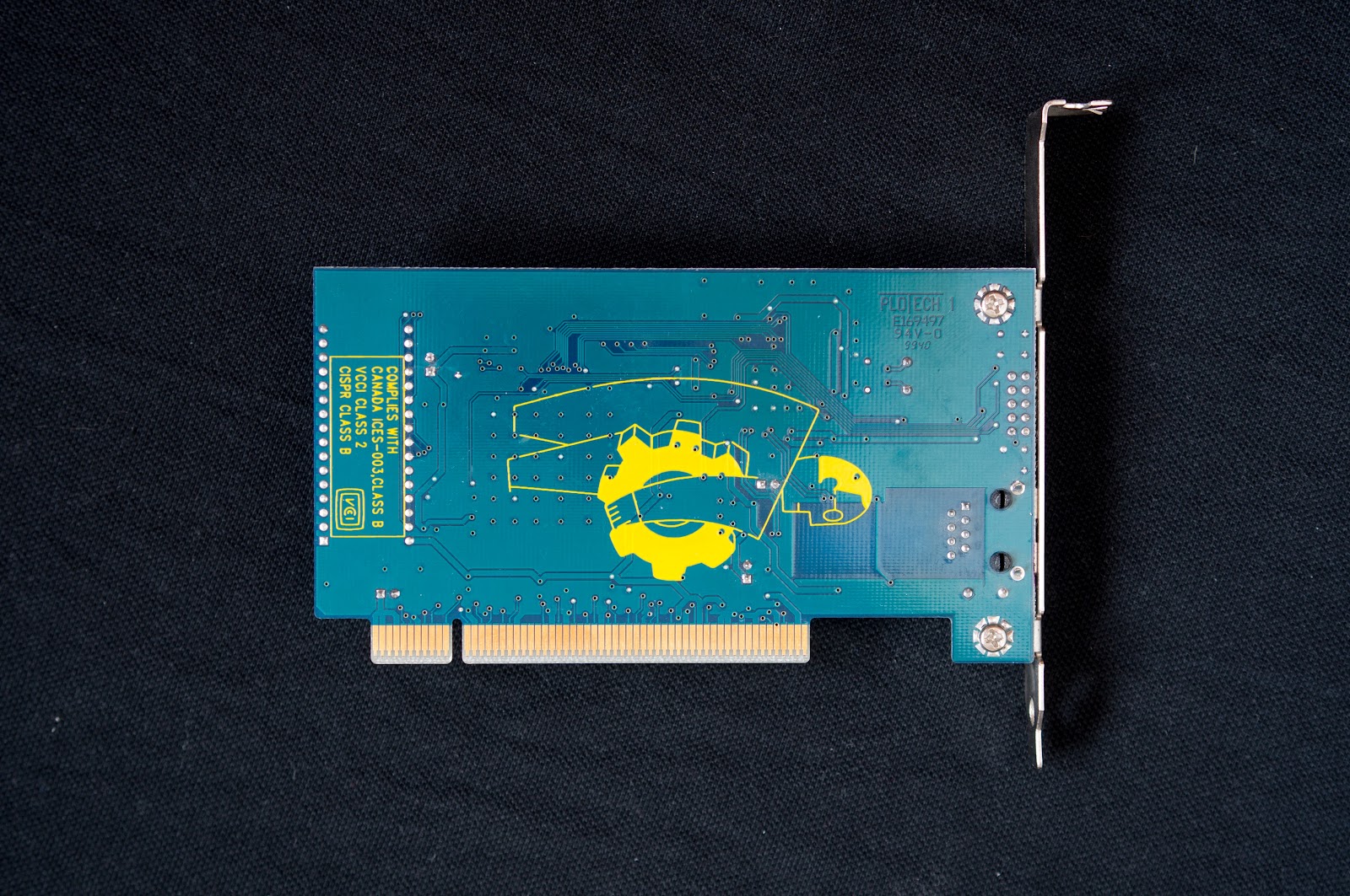

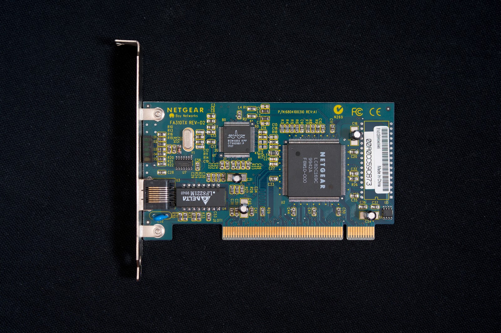

5. Network Card
Blue network cards are strongly associated with Netgear. I searched through the Web Archive to find which of the commonly available adapters actually dates back to the year 2000. The choice fell on the FA310TX. It supports full-duplex operation, the PCB is relatively large compared to other network cards from that period, and the ICs are fairly big, which makes the card look appropriately “old.” The shade of blue is slightly different from the motherboard, but once the card is installed it’s not very noticeable.
1eqlSYTaCyRziGTkE7VoLeeOoVDRRqY7B
1Ptm1tZRHu72q8E7XscJBUnWSz31CQZnn
As proof, I’m including two screenshots from the Netgear website showing the exact same card (there were several revisions of it).
