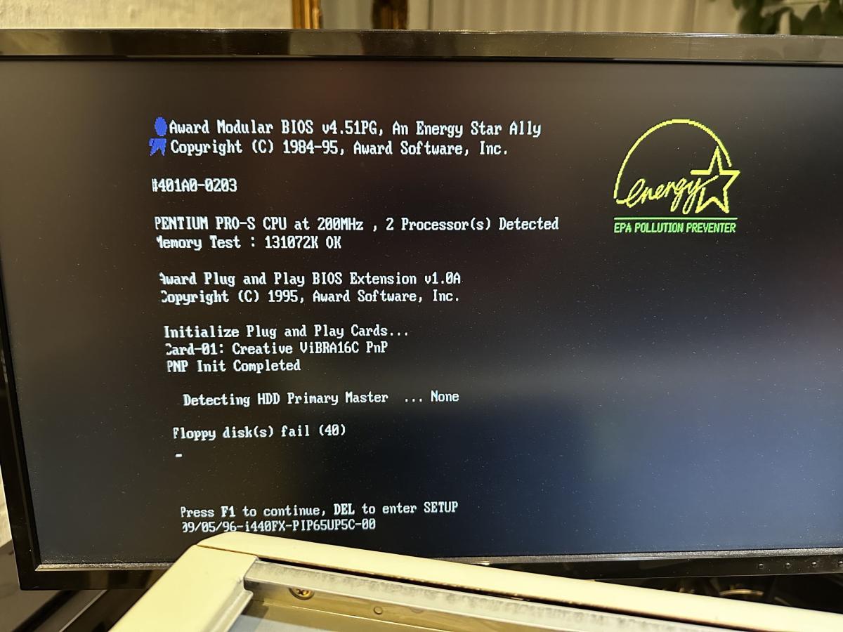

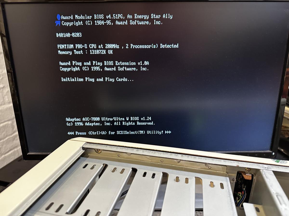

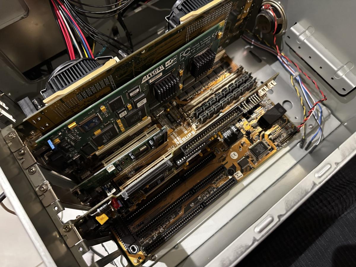

IT LIVES!!! 😎
For the life of me, I couldn’t get the fancy SCSI card not to have an IRQ conflict with the graphics card, so the system’s been reduced to this for now!
The Dynamic Pictures Oxygen 202 seems to assume the IRQ of whatever card is adjacent to it!!! I moved it around and found this!? So hopefully the IRQ can be sorted out properly when I get another graphics card to work in the machine.
Here’s how it currently looks:
This is as far as I can go for now, as I currently have no spare drives to use in it. I’m extremely happy that it’s booting to BIOS.
The next thing I will do when the time comes is a BIOS update!

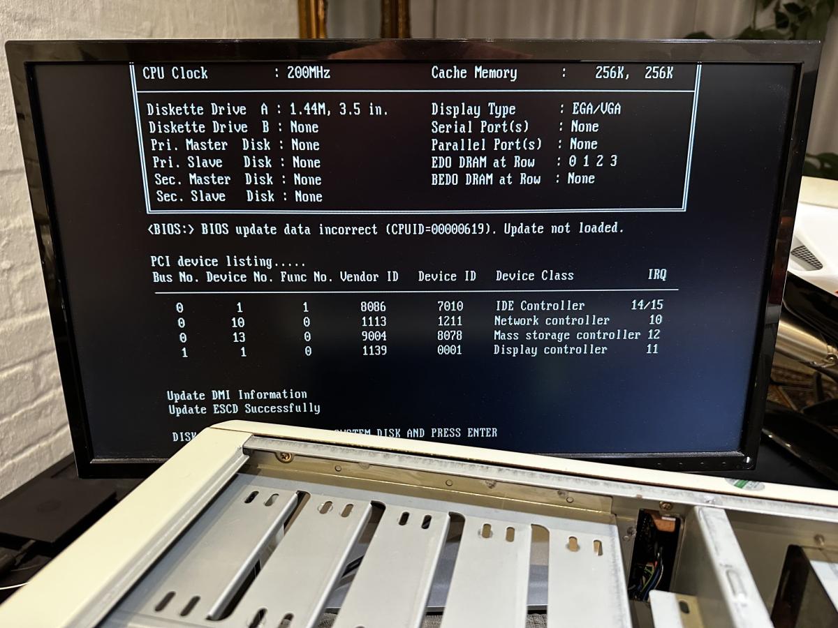

This is the era of hardware irq lines on the pci bus. Have you tried to swap around the scsi/vga card? Its one of those things you dont know to try unless you've been there.
Yeah maybe a "Not all PCI slots can use all IRQs" issue. So can move to a different PCI to give it different ones to choose from.
luckybob wrote on 2026-06-02, 14:16:This is the era of hardware irq lines on the pci bus. Have you tried to swap around the scsi/vga card? Its one of those things you dont know to try unless you've been there.
I did, to no effect.
When I placed it in the second slot it then had an IRQ conflict with the network card (Assumed the same IRQ that the network card was already using.)
Pull the NIC, boot it, save that to the ESCD.... then put the NIC back in a different slot. It's maybe a bit bossy in master mode or something.

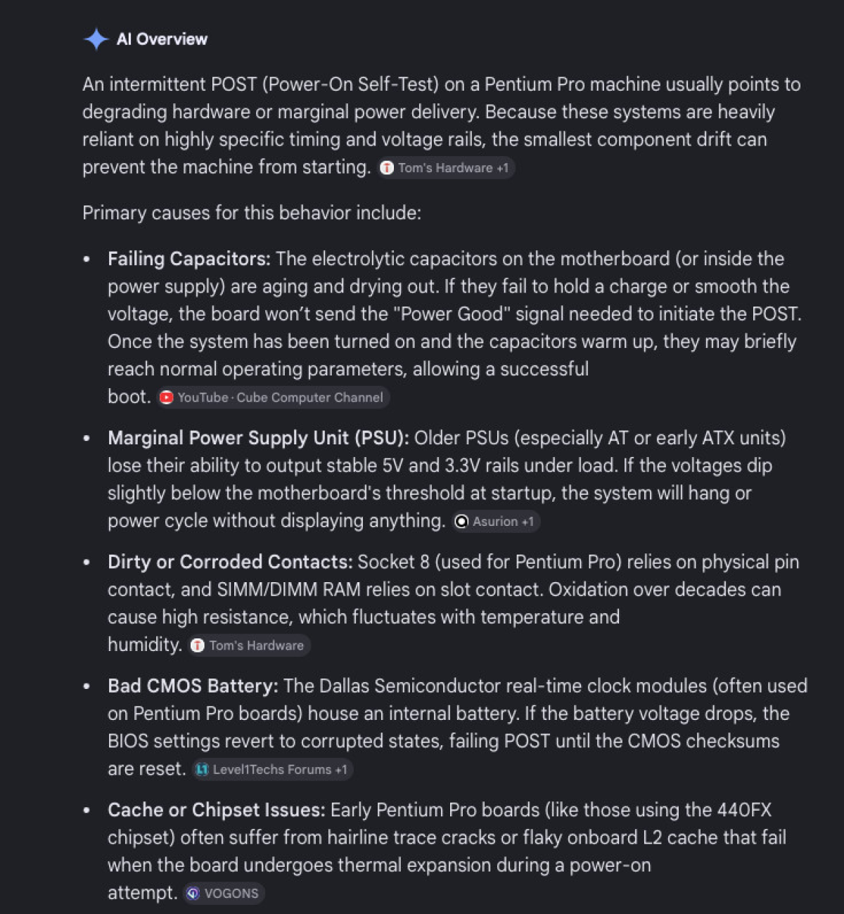

What are the symptoms of a motherboard needing to be re capped? (The caps do look old, as they're original form the year 1995!)

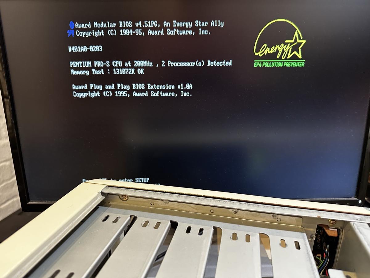

All of the cards are now securely screwed into place, so there’s little to no movement in the slots, and the system sometimes boots and sometimes doesn’t, without me changing anything. It’s currently like a one armed bandit and the jackpot’s a boot.
It has done this in the past, and I always thought that it was due to the CPU card not being aligned correctly in its slot, but this is clearly not the case!
I've tried all kinds of things, but one thing that's for sure is that it's random, and gets worse the more times you cycle the machine.
I'm absolutely going to have to get to the bottom of this problem before I move any further with this build!

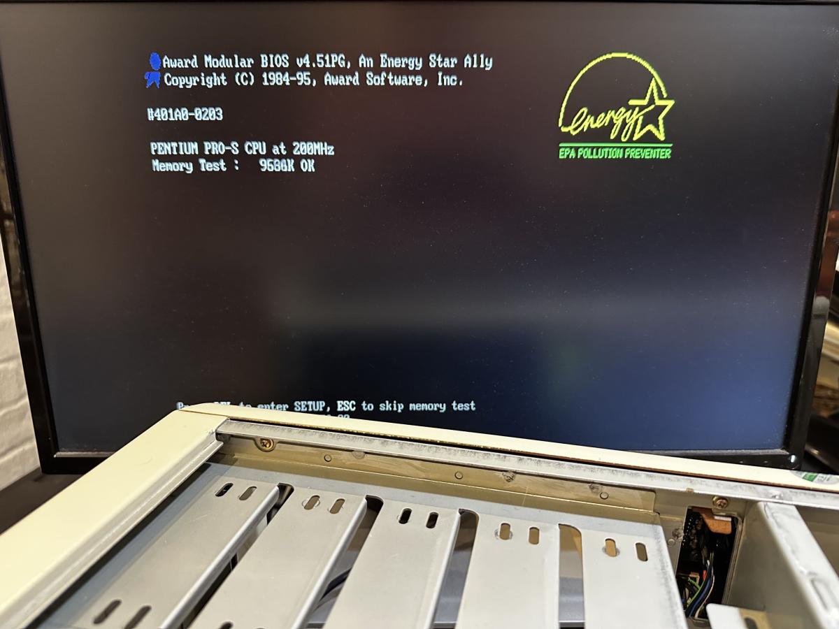

Here is the boot sequence, indicating that everything’s being detected as it should when it does decide to boot:

PCI is designed to allow IRQ sharing. It's not a conflict per se, it will function fine but can reduce performance if both devices are generating a lot of interrupts
maxtherabbit wrote on 2026-06-02, 19:48:PCI is designed to allow IRQ sharing. It's not a conflict per se, it will function fine but can reduce performance if both devices are generating a lot of interrupts
Thanks for the info, I appreciate it! 😀

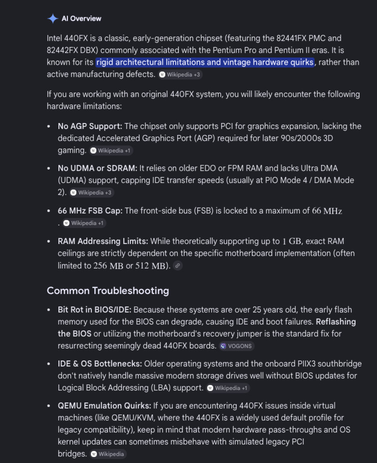

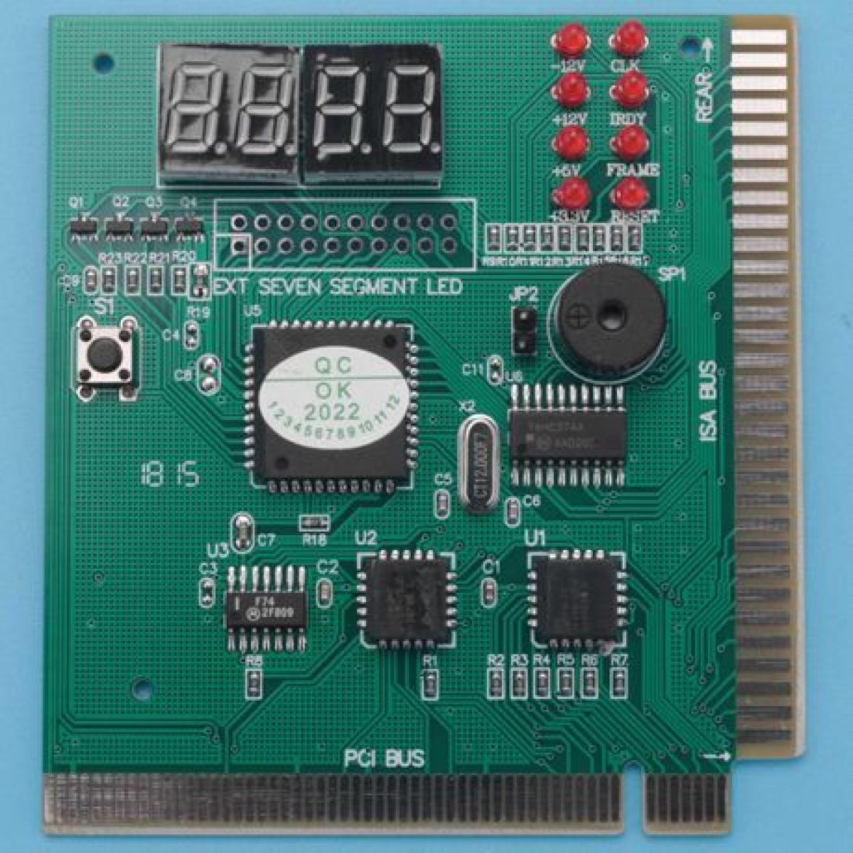

When the dual Pentium Pro fails to boot, absolutely nothing seems to happen when I Power it on except the fans run and the LED on the SCSI card illuminates. I need one of these diagnostic tools to see what’s happening during the POST, to see where it's getting stuck.
I still think that the issue's due to bad caps and will definitely re cap the motherboard and CPU card before going any further, but it will be interesting to see what this card can show me. (Just as a matter of fact the JBC rework station is $6380 without shipping and taxes, hence this is going to take some time!!!)
It could be failing caps, lifting pins on the 440FX chipset due to thermal shock or BIT Rot in the BIOS chip.
