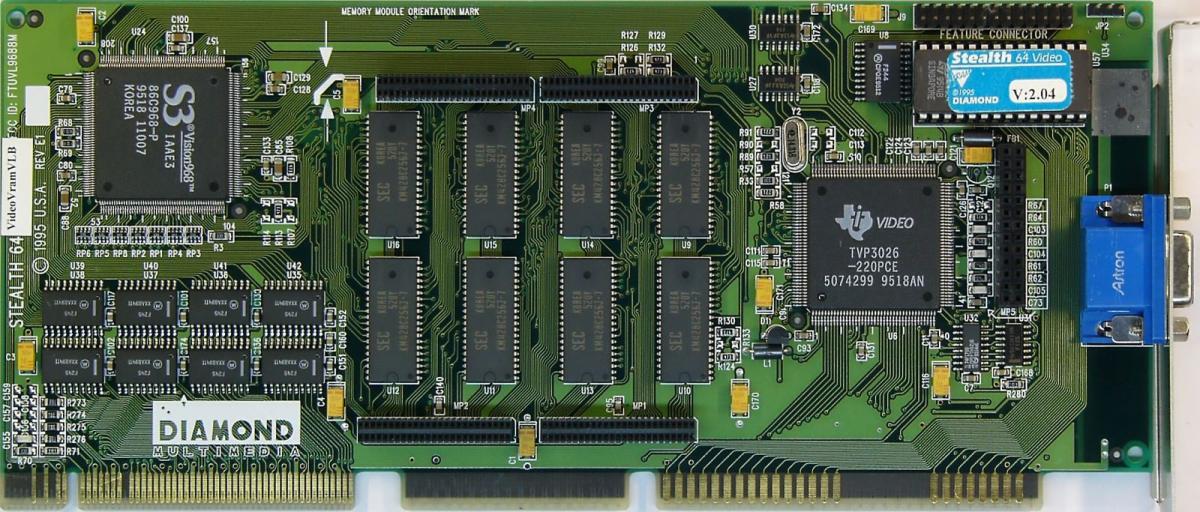

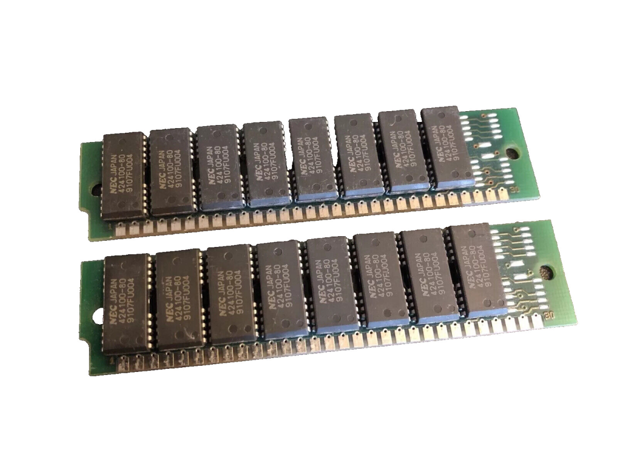

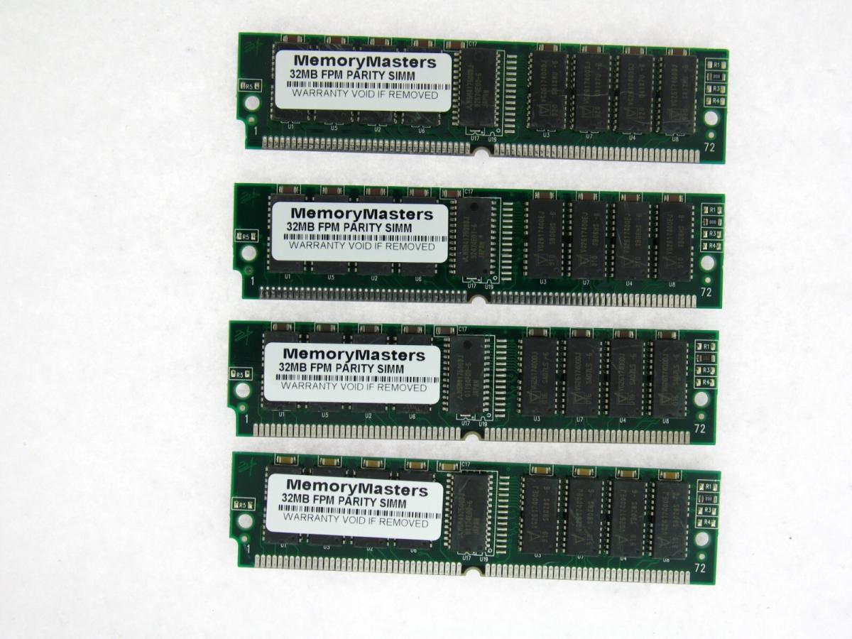

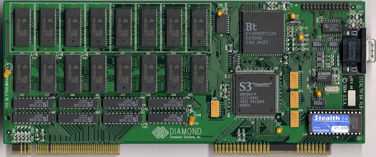

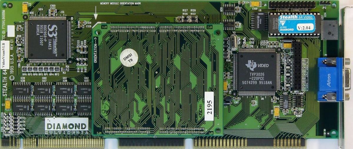

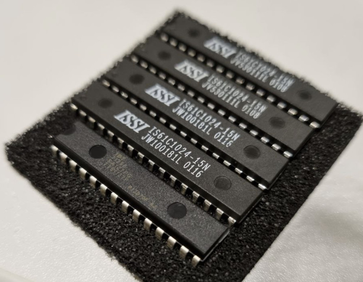

Reply 59 of 59, by Irinikus
I'm starting to do some real planning for this system. (Even though I'm right in the middle of a difficult Dual Pentium Pro build!)
It appears that not all Diamond Stealth 64 VLB cards are equal!!!
These are the two that I'm looking at:
Their specs especially when it comes to their RAMDAC speed differ significantly!
Diamond Stealth 64 Video VRAM VLB (S3 Vision968) is my preferred version of the card as it sports a RAMDAC which runs @ 220MHz
There's currently a Diamond Stealth 64 VLB (S3 Vision964) avaialble on eBay for quite a hefty price:  https://www.ebay.com/itm/124333502801?_trkpar … Q4CM3KYDGRC9QJC
This card's  RAMDAC only runs @ 135MHz though!
I've ordered 512KB Cache for the system:
It turns out that the system can take 512KB of Cache, allowing it to Cache the full 128MB of RAM which can be slotted!
Well that's according to The  Retro Web: https://theretroweb.com/motherboards/s/ibm-pc … 71,-pc-350-6581
My particular board is IMG 2 of 8 on this page.
It's currently fitted with a 486 X4 100 CPU, 32MB of RAM, a 540MB Hard Drive, a quad speed Creative CD-ROM and a Gravis Ultrasound Plug & Play.
It needs the cache upgrade as well as a Diamond Stealth64 VLB with 4MB of video RAM to be completed.
I'm also going to be ordering 2x matched 4MB SIMM's for the Travis Ultrasound, giving it 8MB of RAM as well as 4x 32MB of matched  FPM Parity SIMM's to give the system 128MB of system memory:
