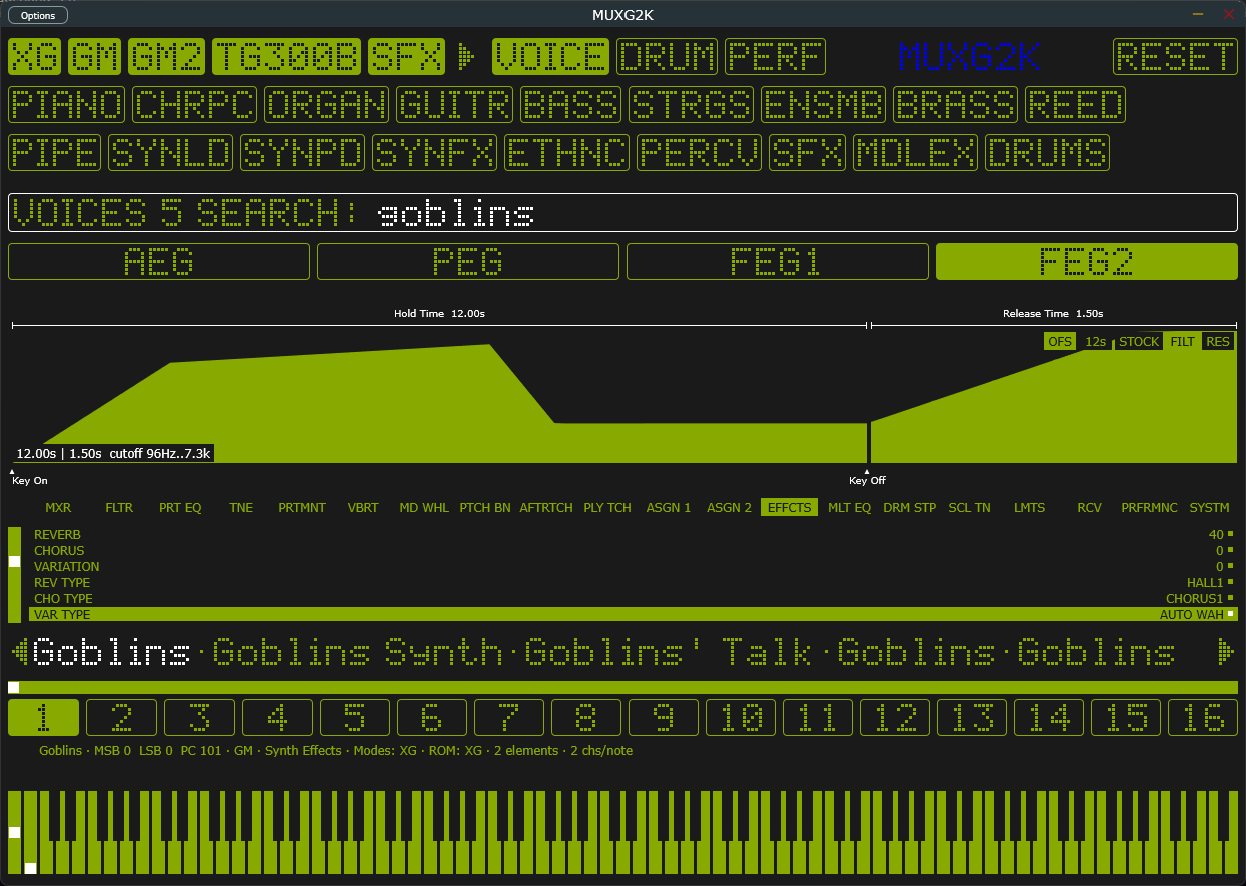

Almost Done. Here's a random doodle through MUXG2K voices. Still plenty of bugs, but the big ones are done.

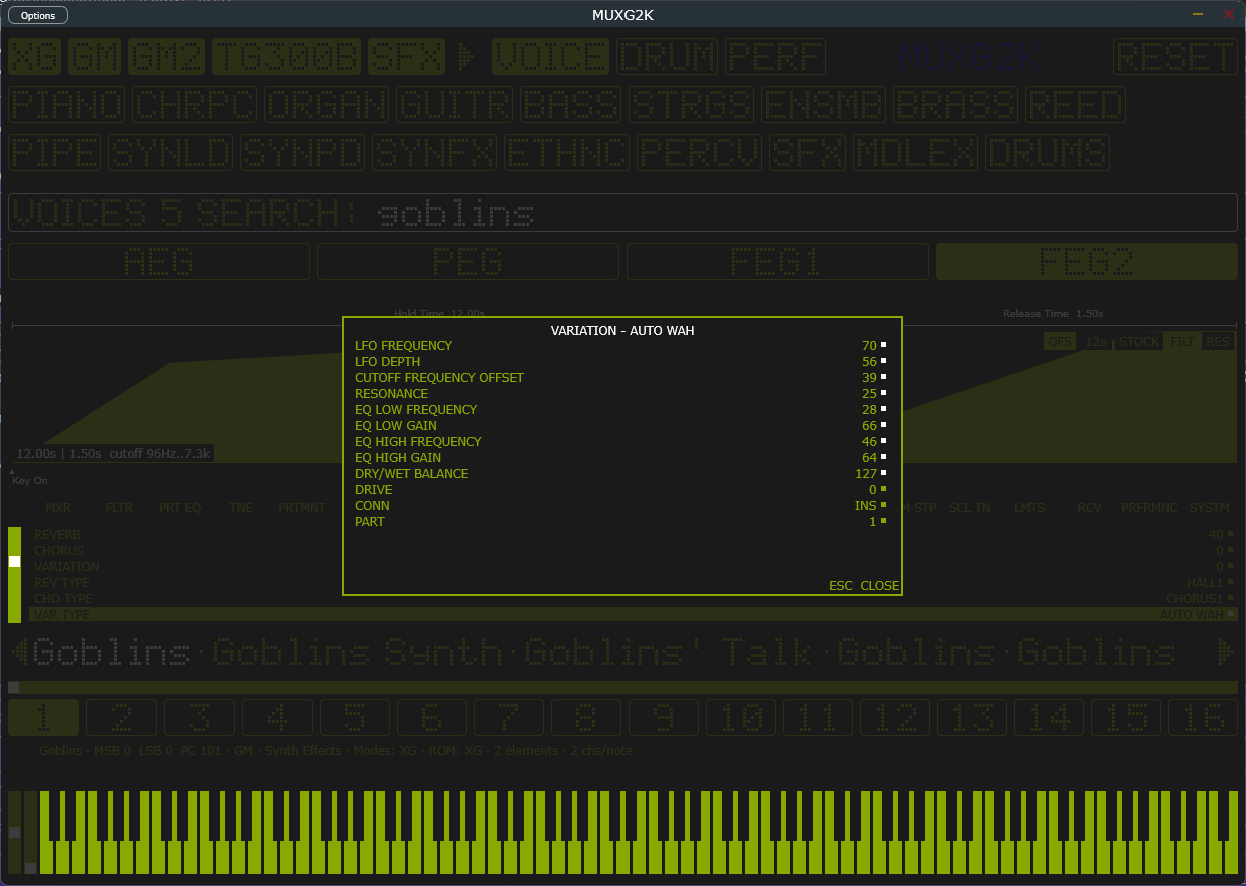

I've now added complete XG V2 MIDI support, along with full 16-part multitimbral operation, so it responds to all incoming MIDI, including SysEx.
I've also wired up all of the effects and every parameter used by the MU2000 hardware. The challenge is that the MU2000's DSP isn't implemented in a way where you can simply look at an effect algorithm and reverse engineer it. Yamaha designed it as a much more modular system that's tightly coupled to the hardware.
I've implemented all of the effects and their parameters, but that side of the project is a lot more work—probably more than everything I've done so far—because it all has to be understood and represented as software DSP. The good thing is that Yamaha documented the parameters and signal flow well, so there's a solid foundation to work from.

No with the FX. They're rough placeholder fx at the moment. They do what they are supposed to do but won't sound the same. In terms of voice DSP, it's finished yesterday.
