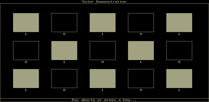

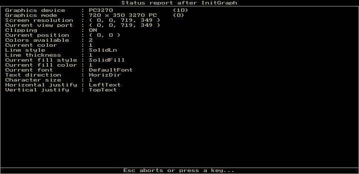

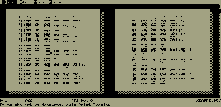

I managed to add PC3270 mode support to DOSBOX-X. Here is the proof from different programs (Borland BGIDEMO, DRHALO II, MS WORD 5.5):
