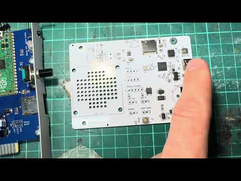

Reply 47 of 69, by MaverickUK
mkv-front.png?width=1000&v=1dd02edcfcc15a9
Introducing the MKV prototype
I believe this is the final form of the HDD Synth before I go ahead with the Kickstarter later this year
http://www.strifestreams.com

Reply 59 of 69, by MaverickUK
The HDD Synth MKV hardware has arrived!
Watch demonstration of HDD Synth Prototype MKV
This is pretty much what I'll be launching as a Kickstarter before the end of the year. It just needs a few minor tweaks before it's finalised.
Also on the HDD Synth Win32 front, the latest release is available from https://github.com/MaverickUK/HDDSynth_Win32/ … ses/tag/v0.13.1
