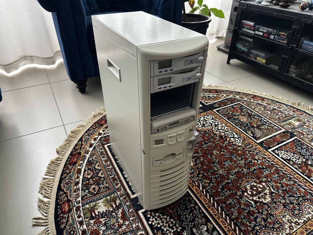

Reply 282 of 284, by Irinikus
I've purchased this NEC MultiSpin 6Xe CDR-602 External SCSI 6x CD-ROM Drive Caddy S/PDIF, which is tested and working as well as this Pioneer DVR-S201 External SCSI DVD-R Authoring Drive DVRS201 for this system: (So I'm getting there slowly)
Both of these drives will be removed from their external enclosures and slotted into drive bays in the system.

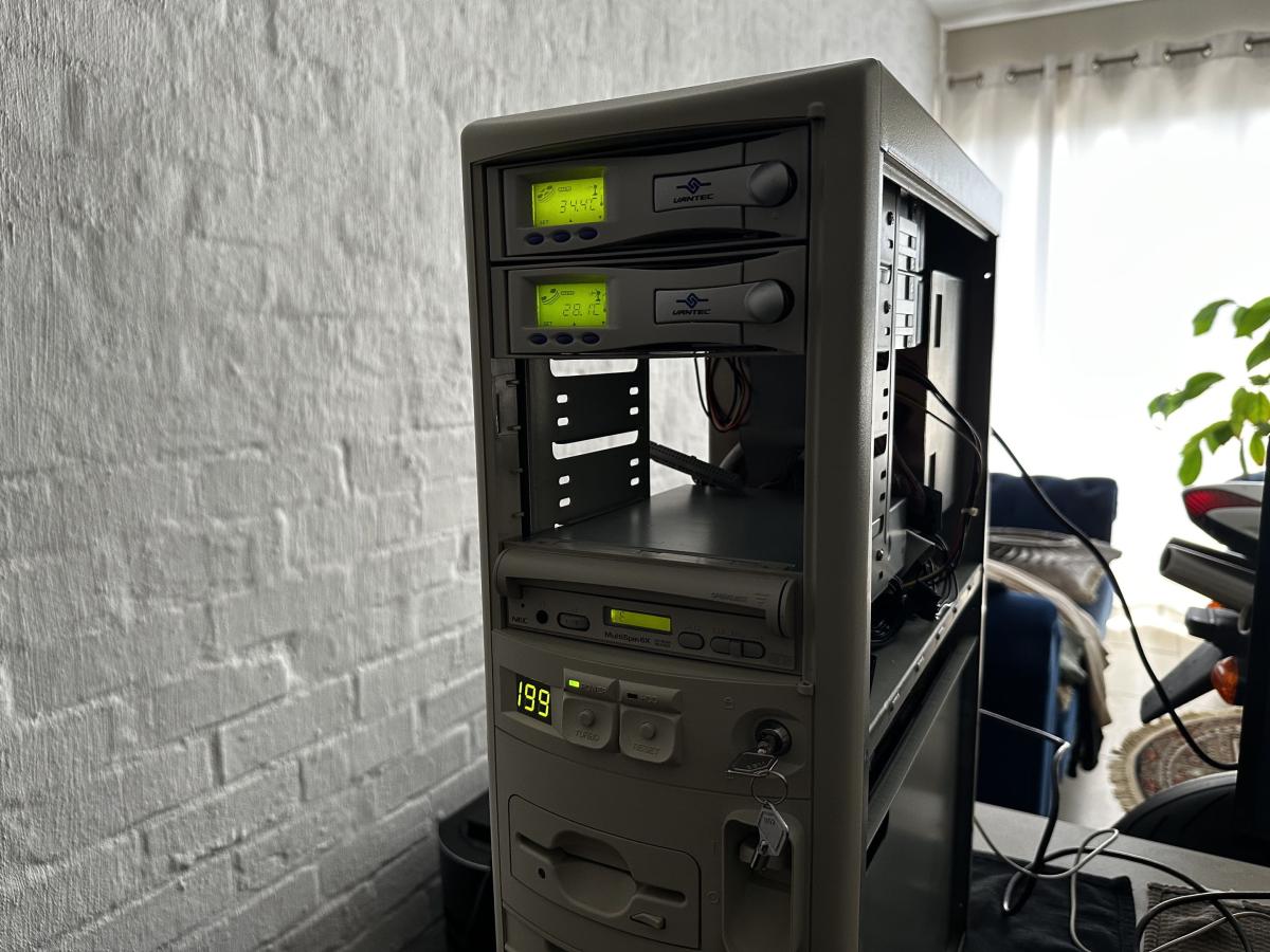

Reply 283 of 284, by Irinikus
I've just ordered this 68-pin SCSI Removable Drive Rack to house the System Disk:
Here are its specs:
And I've also purchased this USB header, which will fit into one of the open parallel port openings on the rear of the case:

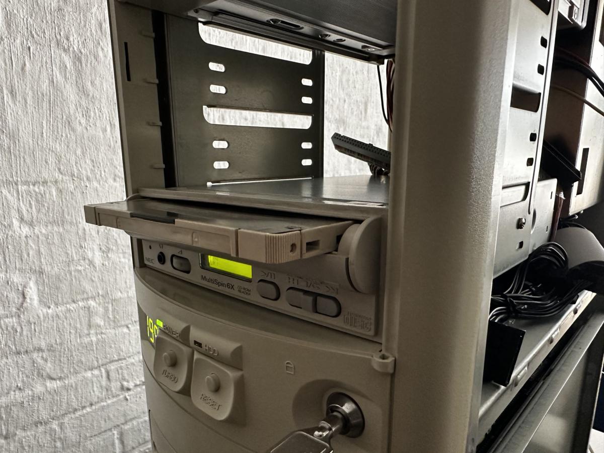

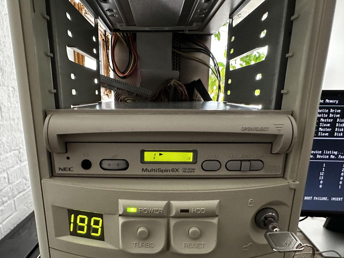

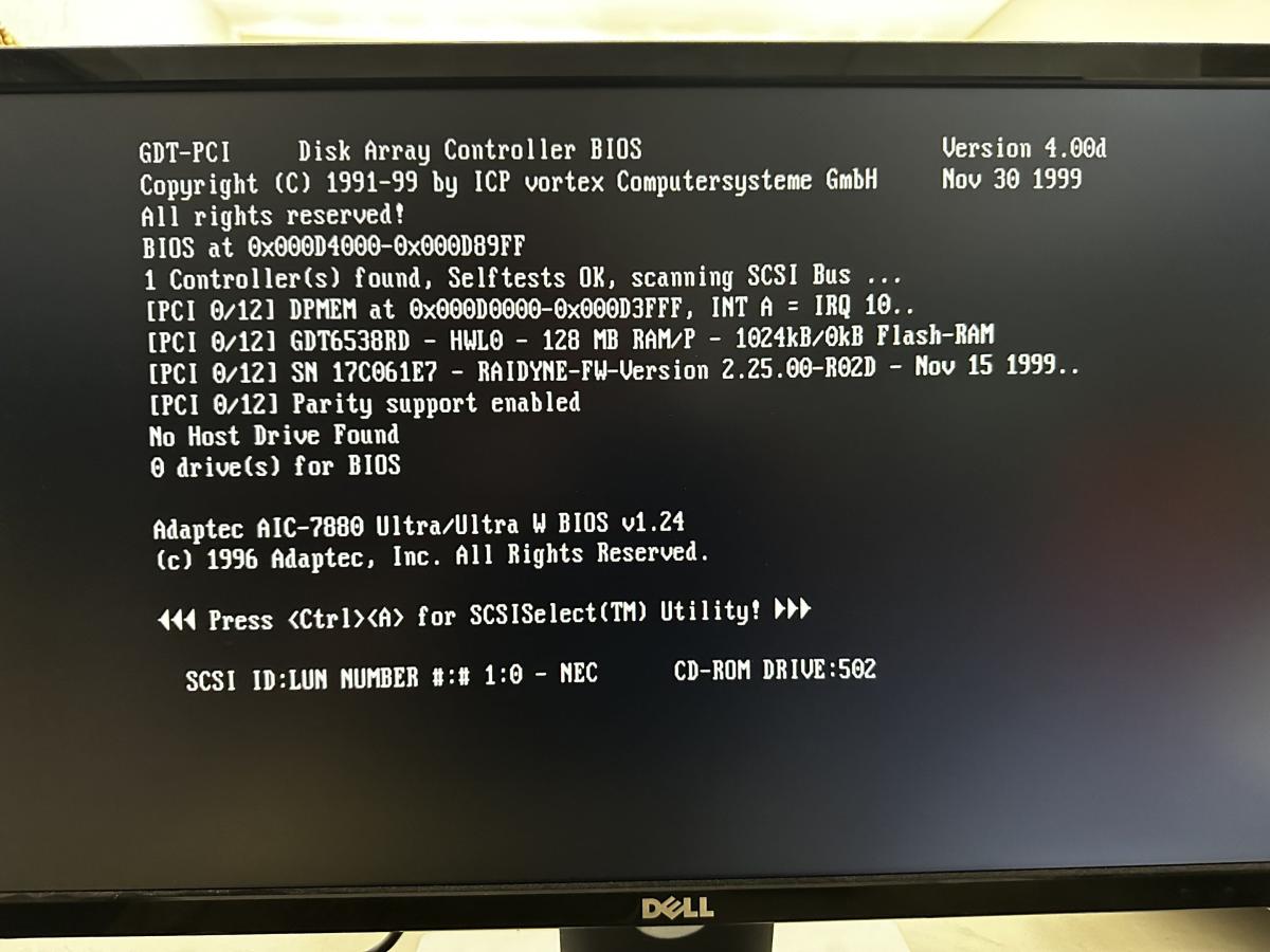

Reply 284 of 284, by Irinikus
The NEC Multispin 6X is installed and working!
