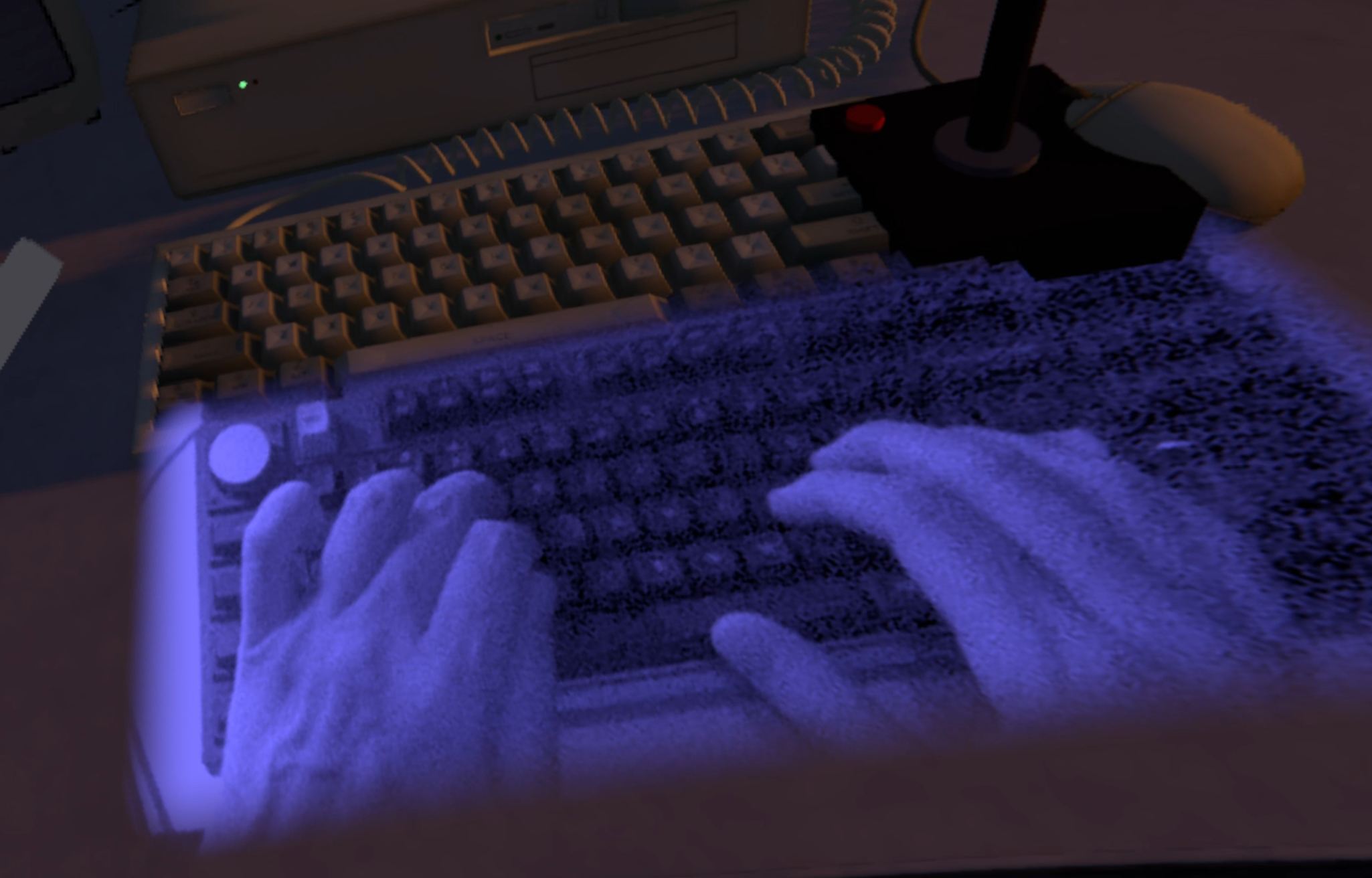

Physical keyboard visible in VR
The new `keyboard` setting in `[vr]` shows your real keyboard, and your hands on it, through the scene with the headset's cameras, in a soft-edged window on the desk:
* `auto` puts it below the screen, then learns where it is from where your fingers press keys while the hands are tracked.
* `marked` puts it where you marked it with a controller, from the settings window's VR page

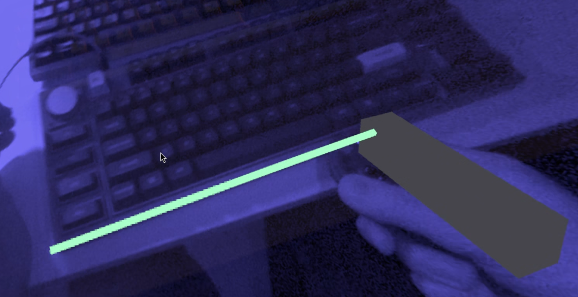

To manually mark the keyboard position, first select the bottom left corner of your keyboard, then pull a line to the bottom right corner.

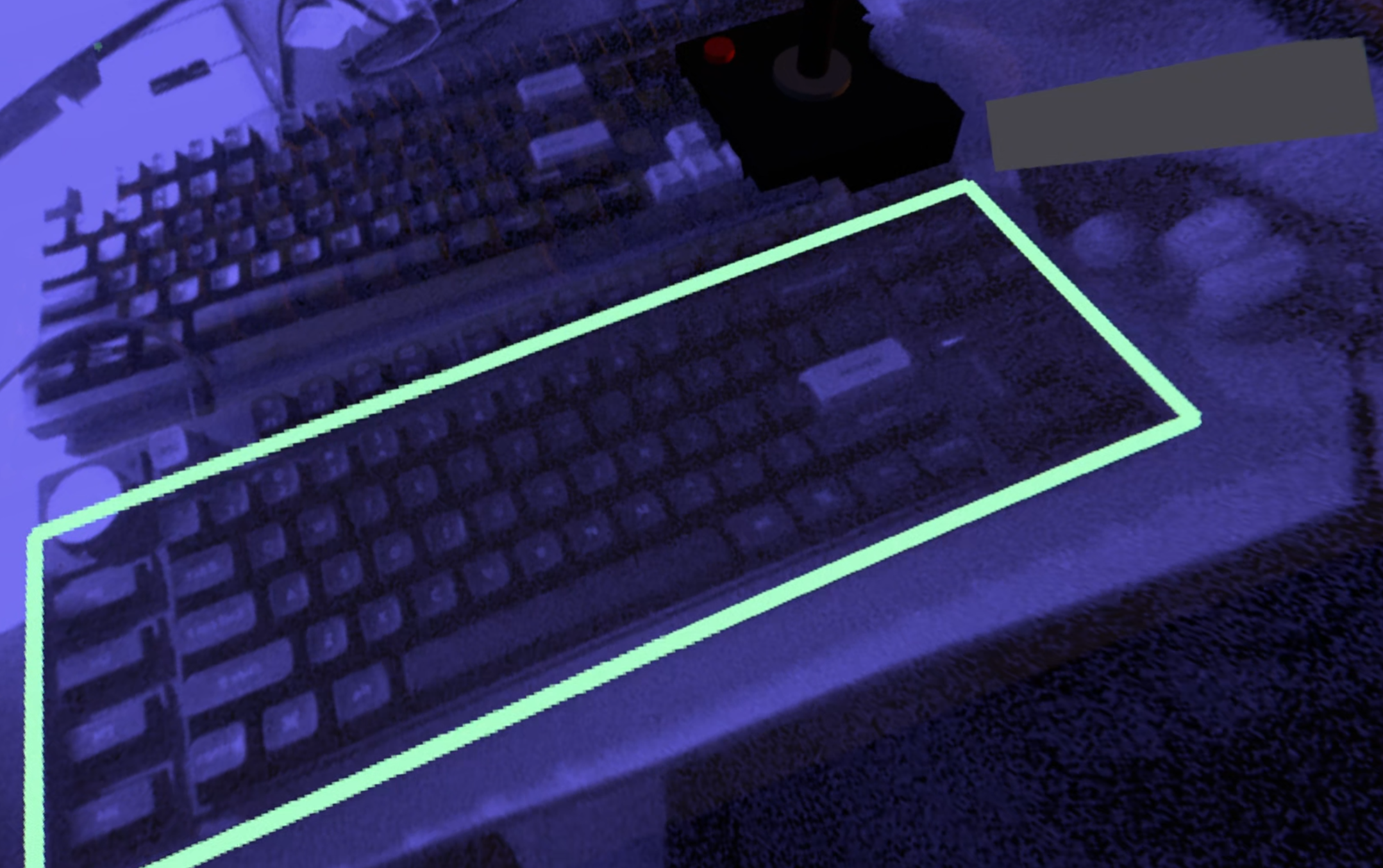

Then just drag the square upwards to encompass the entire keyboard.
