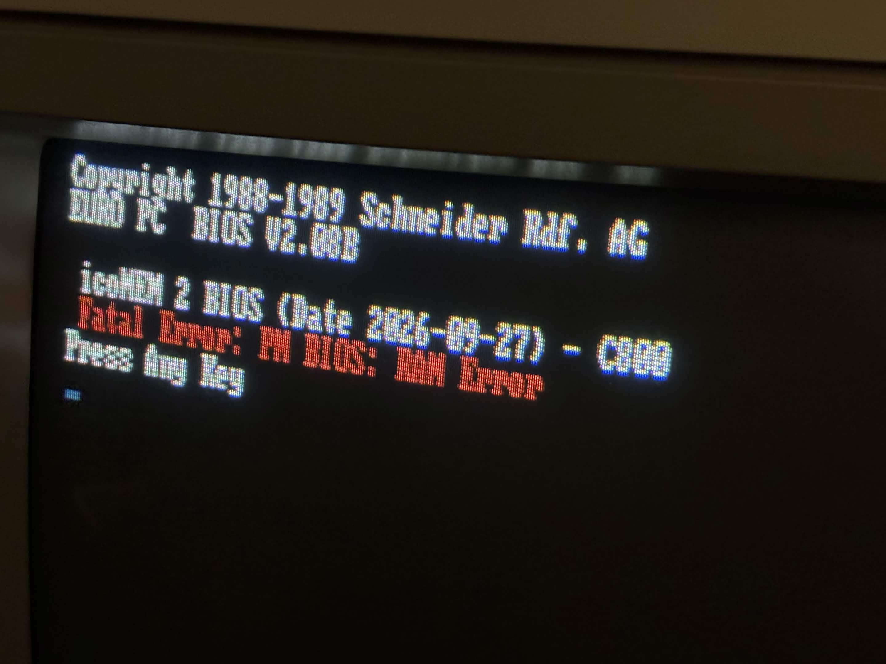

Reply 448 of 449, by RetroBard
NeilKnows wrote on 2026-10-13, 10:26:
dr.zeissler wrote on 2026-10-12, 20:57:
RetroErik made a Demonstration Video on PicoMEM2 on EuroPC.
Also consider a) removing the card/cleaning socket and edge connector b) removing the config file if used the PicoMEM on another machine c) try anohter SD card at some point.
HTH
I tried cleaning the ISA slot with contact cleaner similar to DeOxit, and removed the picomem.cfg file from the card. I will need to get another SD card and try it also.
After installing the latest firmware, the Picomem ”splash” text is still slightly corrupted, but it says ”C800” at the end:
IMG_1275.jpg?ex=6ad246e5&is=6ad0f565&hm=8941482273563eef14c24c8ec90e988668ba7c5b5e7f9895a97ec44539339cb0&
I’ve tried C800 also, but with that the card doesn’t get recognized. CD00 gives ROM checksum error like CE00.
Out of curiosity. If I leave the config.txt blank, did PicoMem have some default address for its BIOS code?
Reply 449 of 449, by NeilKnows
RetroBard wrote on Today, 15:53:
Pretty sure it's C800 by default...
