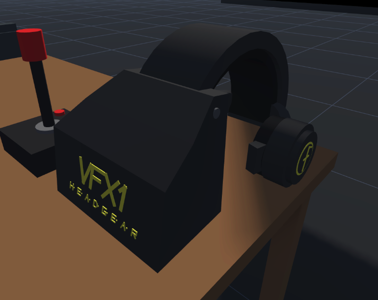

VFX1 emulation
(Inspired by https://github.com/LeonG-ZA/forte-vfx1-vr)

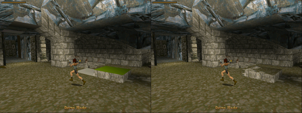

Enable VFX1 in settings and a headset will appear on the table. You can put it on and take it off at any time - just grab it and put it over your head to wear, and grab it from your head and put it away to remove. Running any VFX1 enabled game will render as stereoscopic 3D inside your VR headset while you are wearing the virtual VFX-1, and will render as left/right eye image on the VR monitor if you remove the VFX-1 from your head.
This is not really something that can be shown with a screenshot - you'll have to try this out yourself.
NOTE: Resolution and FOV are limited to the original as supported by the respective games. This feature only works in VR headsets, it wouldn't make much sense on a 2D screen.

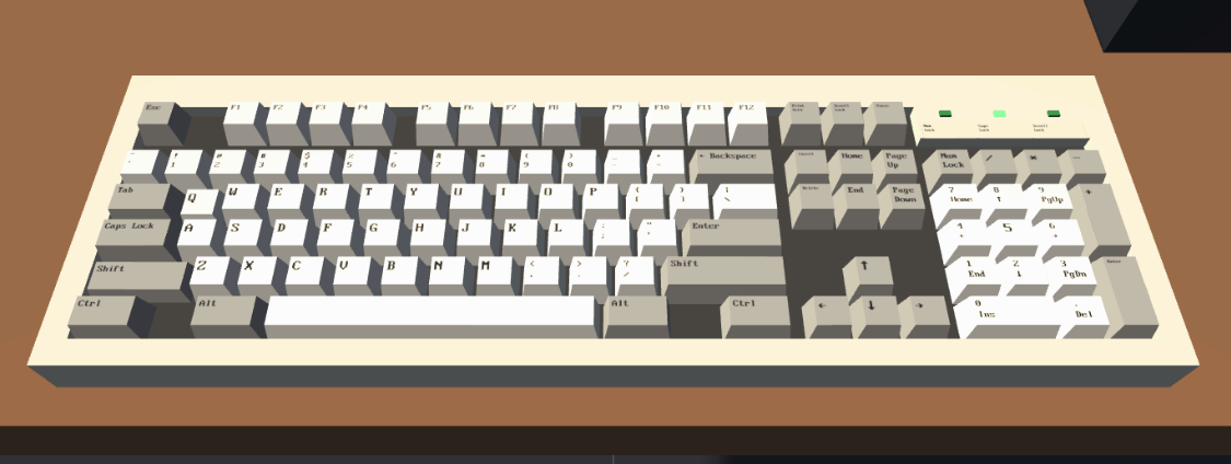

Usable VR keyboard
If you just want to try something out quickly without a connected bluetooth keyboard, there's now a VR keyboard that can be used and grabbed with the VR controllers.
NOTE: The bedroom scene has been updated, please go to the scene list and download the update right inside Rust-DOS.
