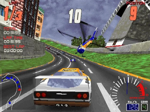

Screamer finally gets Voodoo 3 support!
This game never had any 3DFX patch, it's now a thing !
As many remember only Screamer 2 & Rally had a 3DFX patch.
This new exe allow to launch Screamer on Pure MS-DOS using your real 3DFX Voodoo 3 GPU !
Full GPU acceleration, expect 50-60 fps along with a decent CPU (from Pentium II 233Mhz).
1) Copy and replace STARTH.EXE and STARTL.EXE to game folder
2) Make sure to use XMS Memory under Pure DOS
3) Run STARTH.EXE the game will use your Voodoo3 for all 3D rendering.
DOWNLOAD:
Screamer 3DFX Voodoo 3 Patch (2026)

Reply 2 of 11, by Johnylyr
Will it work with other voodoos like voodoo 1, rush, banshee, voodoo 2?
Reply 3 of 11, by TgamesFR
Johnylyr wrote on Yesterday, 21:03:
You can test on the Voodoo 2 and banshee (as the API i'm using is based on the Glide 2.X) but i doubt that it could works.
For Rush, Voodoo 3, Voodoo 4, Voodoo 5 they will works fine.
But Voodoo 1 no.
I only own a Voodoo 3 that's why i'm doing all thoses patchs for this card.
Next patch coming is Duke Nukem 3D for Voodoo 3 😀.

The patch seems to work fine on my system, the only visual glitch I can report is that the track occasionally has small gaps between polygons that is not present on the software SVGA renderer
