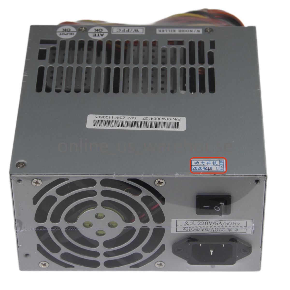

speaking of power, the current power supply that I have fitted can only supply 5V@20A maximum, and this thing needs at least 30A on the 5V rail, so I've ordered one of these industrial power supplies, which gives me 30A on the 5V rail and it also gives me -5V, for what it's worth: (FSP FSP300-60ATV (PF) 300W Industrial Computer Standard Power Supply)
Judging by the gauge of the cables, this thing should be up to the task!

mockingbird wrote on Yesterday, 21:26:
Irinikus wrote on 2026-10-26, 14:49:
That is a very OLD STOCK (read: 2003 or older, depending on revision) part and you will need to preemptively re-cap it.
Also, the FSP units of that era use the old fashioned standby circuit which gets hot even when the PC is powered off. Make sure to use high endurance caps in that area (usually it's two 6.3V/10V 1000uF, as well as some small 6mm and 5mm parts near where the purple wire is soldered into on the PCB).

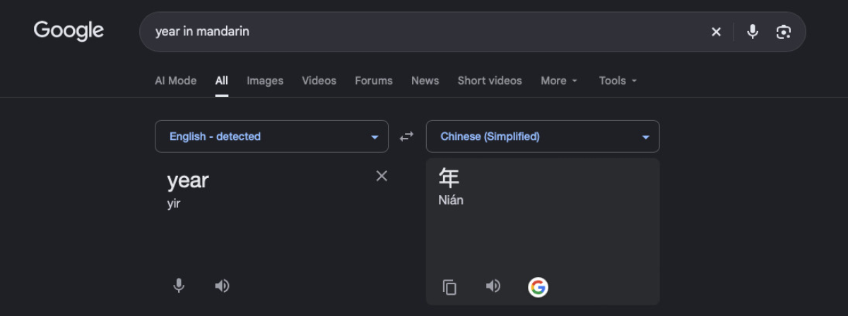

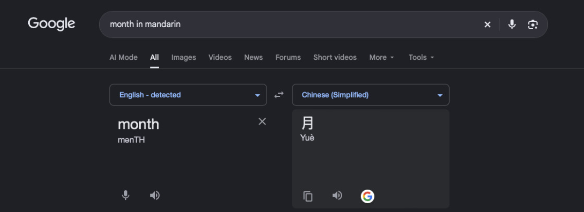

This one appears to be more modern, as it has a date sticker on it which references 2020. (They could maybe still be manufacturing them for legacy industrial machines.)
So according to the sticker it was manufactured in the fourth month of 2020.
I'll check it when I get it!

Irinikus wrote on Today, 12:33:
Yes, you could be right! Looks like a very late revision since it has power factor correction.
Can you show is the innards when it arrives? I'll wager it has Teapo SC... I would still reaplace those, especially the two by the purple 5vsb wire.
