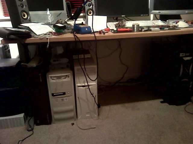

Thanks for all the replies - I think I'm going to try and put something together around my original PC motherboard and processor 😀
The needed components seem to be fairly readily available - the only part that seems relatively expensive are ISA VGA cards (I'm going VGA as the system originally had one)... so that might take a bit longer to get.
Only thing I am now thinking about is to try and find a case that is quite compact... I just don't have the room for the typical tower case! Any more tower cases and I won't have room for my legs under the desk!!!
This might be a problem as there are plenty of nice ATX designs, but something to fit a baby AT board might be a bit more of a struggle 😁
(excuse the mess - been putting some electronic kits together today)
