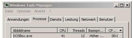

I have looked into the issue, since it seems to come up occasionally. I used a game for this which is rather cpu-intensive to emulate. It is Archimedian Dynasty. I put the taskmanager beside the DOSBOX window to watch both of them.
Okay, i know. DOSBOX does only use one core. If that is so, then someone please tell me why does it have 12 threads? It always runs 12 threads. Nothing one changes in dosbox.conf could change that. The multicore load balancer of windows will distribute the load quite evenly as i have noticed. And rightly so. Distributing load means distributing threads between the cores. Does anyone please know what each of the threads does? One thread for the emulated CPU, one for the video card and so on... ?
All emulated devices have to run in parallelism for games to not run very choppy. Thus several threads are needed. Even on a single core. Or would you say otherwise? And yes, i know true DOS cannot run on multiple cores. Very possible that a game itself does use one of the threads. It has to. So it seems the other threads are used for the emulated devices.

    Taskmanager shows 12 threads for DOSBOX.
    Hence DOSBOX doesn't need a rewrite for multicore use.

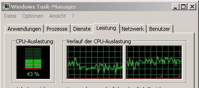

    53.87 KiB
    4416 views
    The load of DOSBOX is distributed quite evenly between the 2 cores. Depends on the game and its load.

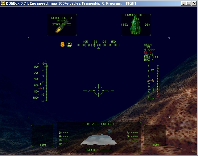

    160.62 KiB
    4416 views
    Archimedian Dynasty

The dosbox main thread does all the work. The other threads are some auxiliary threads created by DirectSound etc. Also, multiple threads doesn't automatically mean parallel execution. If the threads access shared resources protected from concurrent access often, the threads will be waiting for access to that resource instead of doing useful work. Also, the operating system scheduler can distribute a single thread over multiple cores - but you will get an average 50% utilization of each core, which can be seen from your picture.

What ripa probably meant to say is that a single thread can "jump" from one core to another, depending on where the scheduler puts it. Since the timeslices are way too short (10ms) to be able to see this in realtime, you can only observe that each core is used roughly half the time. But that still means that only 1 thread is doing most of the work and things are not running in parallel (or the cpu usage would be >1/no_of_cores).
