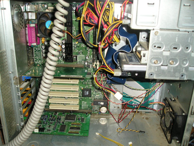

Here's the Specs (2016 Update) of my Retro PC I built from old parts I had lying around. It may look crusty, but it runs like a champ!
Tyan Trinity 400 S1854 Motherboard
Intel Pentium III 800EB 133MHz FSB
Crucial 256MB PC133 SDRAM @ 100MHz
NVIDIA TNT2 Vanta 16MB AGP 2X
Creative SB Live! CT4760 w/ SB Pro 2 emulation (Roland SC-55 SoundFont)
COOLER MASTER Elite RS-460-PSAR 460W PSU
Cambridge SoundWorks Stereo Speakers
Sintech IDE to SD adapter (PNY 4GB SDHC..Going to update this soon!)
TEAC DVD-ROM Drive (Black)
3Com EtherLink 10/100 3C905C Network Adapter
Slightly yellow, but very sturdy beige Mid-ATX tower

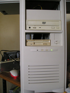

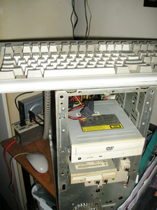

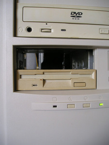

Reply 6 of 19, by simbin
I've been cleaning up my case IT'S A REAL MESS !!
Notice the difference between the front of the case and the floppy drive, sleep and reset buttons YUCK !!

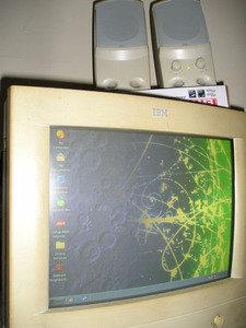

Reply 9 of 19, by Filosofia
Very cool system! What's the monitor? Have you had any trouble running dos games with that 800MHz PIII?
and I see you can use sloted cpu as well 😉

Reply 11 of 19, by simbin
I'm using a IBM G54 on my workbench. Once I finish the system, I hope to pair it with a Sony Trinitron. I actually had one that someone wrote all over before I knew about the Magic Eraser!

Reply 12 of 19, by Filosofia
I love "old" those 14"-15" crt , they are great for 2D later 80´s games /early 90's , and yes the trinitron are the best, my favorite, but a lesser quality crt sometimes gives a better look to the game.

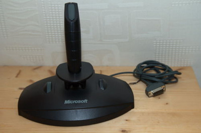

Reply 18 of 19, by simbin
Just picked up this Microsoft Sidewinder (96679) from a local thrift shop for $1. Only has 2 buttons, but it handles great!
