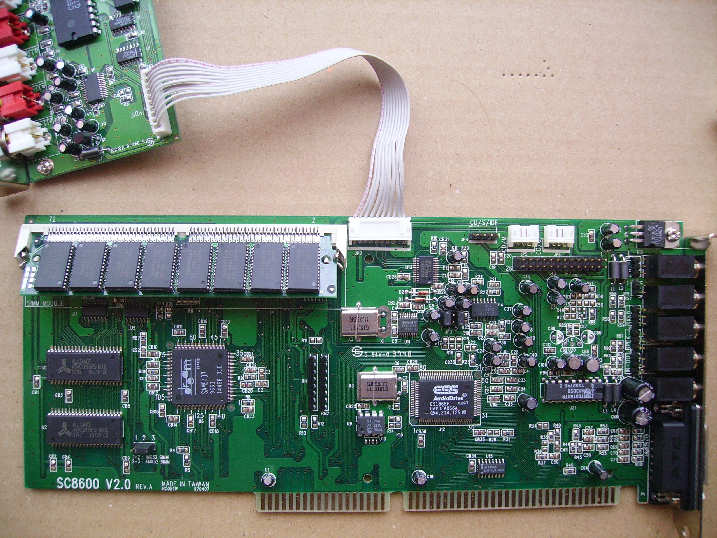

Reply 3 of 46, by retro games 100
Here's a pic. I'm not too sure what that thing conected to it is, but on the end of it, there's 6 gold plated "hi-fi" sockets.
Reply 4 of 46, by HunterZ
The connected second board is probably the "digital daughterboard" mentioned on the link you posted:
Digital Daughterboard to set up a digital stereo S/PDIF 44,1 kHz Input/Output. Stereo analog RCA input/output jacks with gold-pl […]
