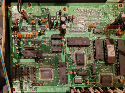

Reply 8 of 10, by perhenden
The Roland E-10 keyboard contains this voice board too. It is revision 00 in my case, and has the same assy number as in these pictures. The socketed MT-32 ROM on this board says "2.0.0".
I hope to one day do the above project with my E-10. Not sure if my board is working though, that will be the first thing to check. I should compare it with my MT-32, both electronics and audio output. It looks to me like E-10 has the same synth board as E-20, but has a different CPU-board (left board/synth equal, middle board/cpu different, right board/power equal), based on the images referenced in this thread.
Image of the board found in my Roland E-10:
1.74 MiB
1250 views

Reply 10 of 10, by tnt23
perhenden wrote on 2021-12-09, 19:56:
Some years ago, but I wonder how did you attach the MIDI port? By running a cable to the other board in the pictures, or on the same board?
First runs were done via onboard connector with TTL MIDI signals. The said pin connector used to be attached to another epiano control board sending MIDI flow.
What were the missing parts? I see an added 7805 VRM, a power plug, two pin headers, and a power plug, and the LCD parts. Anything else? Some small ICs in front of each midi ports on the back?
7805 voltage regulator, yes. This one gets rather hot, because in MT-32 it is mounted on the metal case for heat dissipation. I failed to source proper power switch so just soldered a wire jumper in place to always have the board powered.
Then DIN-5 MIDI connector and optocoupler, for external MIDI source.
Then a couple of TRS 1/4" jacks and op-amps with other components, for sound output.
MT-32 Service Manual was of great help, showing both schematic and PCB connections in great detail. So it was just a matter of finding the missing part on the schematic and installing it on the PCB.
