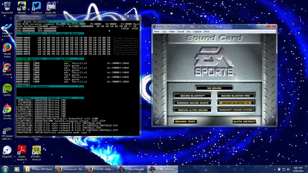

Just got NHL '97 yesterday (lost my old one, found one on amazon) and I cannot get it to work with 0.74, even though Dosbox says it's supported.
I can get to the setup screen, but as soon as I select my soundcard (auto-detect goes to SB 16) and hit the checkmark to proceed the game basically freezes and goes no further. The sound DOES work when I hit "sound test" prior to proceeding with the install.

Reply 5 of 6, by ripsaw8080
Rank DOSBox Author
DOSBox Author
Judging by DOSBox's title bar in your screenshot, the install program has terminated back to DOS. I can reproduce that exact behavior in NHL 97's installer by not mounting a C: drive to install to. Not a very graceful way for the installer to handle the situation, but on the other hand it would be highly unusual on a real DOS PC.
So, make sure you're mounting a C: drive. If you need help with that then try following the "60 seconds guide" in the guides section of the forum.
Reply 6 of 6, by fleshwound_NPG
THAT'S IT
Working now. Thanks. Can't believe I forgot that, so worried about mounting the cd drive I forgot c:\.
