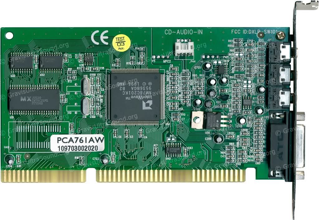

Just thinking at the moment ...
I have one of those lying in front of me ...
http://i910.photobucket.com/albums/ac307/grav … ig.jpg~original
Which can be made compatible to classic GUS cards according to gerwin's post here by adding 512kb of RAM in the intended solder footprint.
EC251 InterWave Audio Card
Might also be possible to easily boost it to 1MB.
AM78C201 & IW78C21M1 chips can still be bought as NOS from China.
Seeing how above card is a 2 layer board, it could be produced cheaply as well (~$20).
Considering GUS cards go for quite a bit these days ($80+ last time I checked) it might be possible for one to solder one's own card for maybe $30 (assuming the custom chips don't cost an arm and a leg from china).
As usual with my projects, I'd reverse the schematic, draw an example PCB layout and produce a prototype and release the files once the design is confirmed as working (I _hate_ distributing stuff) so basically anyone with soldering experience and patience to go through acquiring all parts could build his own card.
What's you guys' and gals' opinion on that?

Reply 1 of 3184, by Scali
The original GF1 is no longer available I take it?
AMD's InterWave is nice, but I've heard people complain about compatibility issues. Apparently the playback rate is not 100% the same, which causes problems with long samples getting out of sync.
But still, InterWave is better than no GUS at all 😀
The GUS is by far the best soundcard for early-to-mid 90s demoscene stuff.
Reply 2 of 3184, by shock__
The GF1 and it's companion chip GF1D1 seem to be a lot harder to obtain and has the sample rate drop issue.
Wouldn't be a good start.
Going with the Interwave chip one could also add a SIMM-72 socket for easy 16MB RAM expansion.

Reply 18 of 3184, by shock__
I think so ... never had a GUS Extreme myself.
As stated ... the PCA761AW would be a nice reference design ... GUS PnP compatible, can be made GUS classic compatible by adding RAM and adding up to 4 Banks of 4MB (each) of extra memory for soundfonts shouldn't be too hard.
And I have physical access to such a card.
