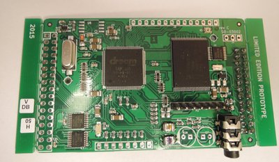

I still have 2 X1's left to go right now (see photo attached, they have the 'limited edition wing').
especially if you like to provide feedback to me, test compatibility with soundcards and games,
do video reviews or promote it online, stuff like that...
Dont worry if you miss those first 2 : I think I will make a small production batch of X1 for you guys.
It will take some time (months) until they are ready and available here : http://www.serdashop.com/DreamblasterX1
What do you think, how many X1's does the world need ?
Let me know if you are interested in the X1 "right now" edition or the X1 production version.
